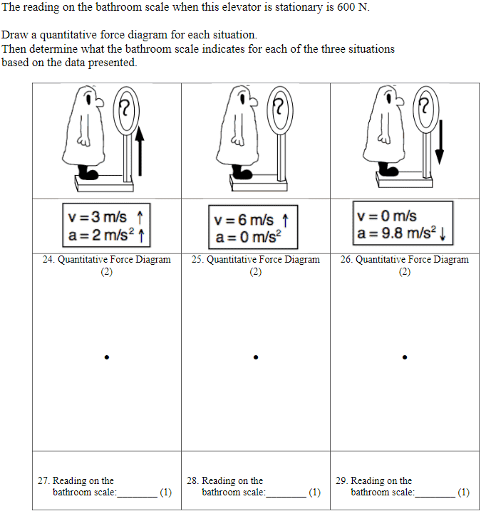

This person is riding on an elevator in a tall building. The reading on the bathroom scale when this elevator is stationary is 600 N. Draw a quantitative force diagram for each situation.
Then determine what the bathroom scale indicates for each of the three situations based on the data presented.
F=M*A
I really need help figuring out where to start. I believe that every graph has a normal force pushing up on the person as well ag gravitational force pushing down on them. Where I am getting confused at is how the velocity plays into the scenario and if an acceleration of 9.8 m/s^2 downwards is just gravitational pull. Would that make the scale read "600 N" for the leftmost graph?

The velocity information is only to indicate direction of movement, if any.
Lnewqban said:
Welcome, Lugytopo! :cool:
Ok--so it has no bearing on the force diagrams or the scale reading?
Please, show us your work and we can discuss further.

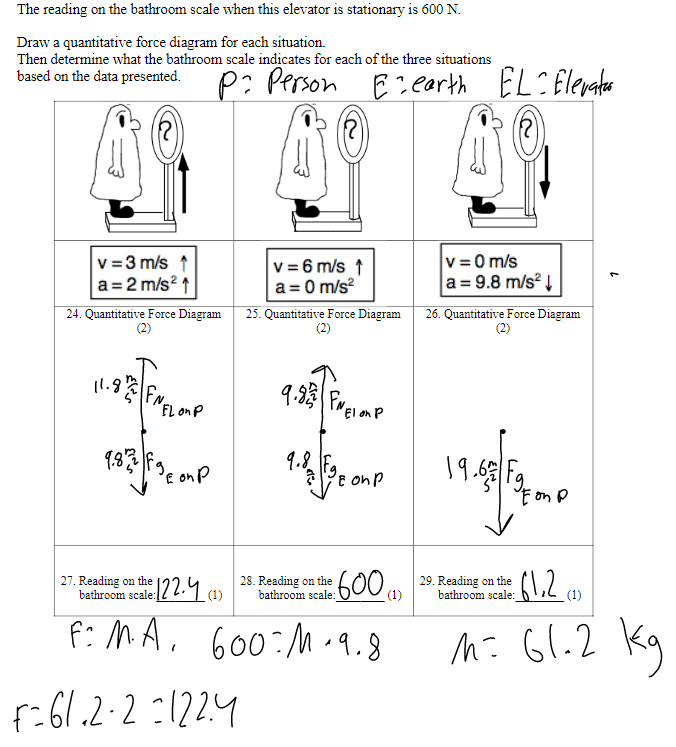

Ok, here is my attempt.
It is the actual acceleration resulting from all the applied forces, including gravitational pull.
Would what make it 600N? It is the rightmost graph that has an acceleration of 9.8 m/s^2 downwards.
In all cases, the relevant equation you quoted is the key; but remember that F is the sum of all applied forces, either as a vectorial sum or the sum of components in a given direction.
You also need to understand the relationship between the scale reading and the forces on the person. What is it?

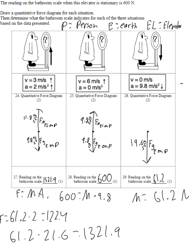

Sure, here is an updated version.

The diagram and equations (hen scratchings) are unreadable. Treat the man's body as a free body. Representing it as a rectangle shape would be adequate. Please show the forces acting on it only (There are only two).
There is a pre-drawn dot in the middle of the diagrams that represent the person. I also thought I showed the forces acting on the person--I only showed 2.
I can see that now. Thanks.
The same force balance equation applies algebraically to all three diagrams. What is that equation (please type it out or, preferably, use LaTex)?
