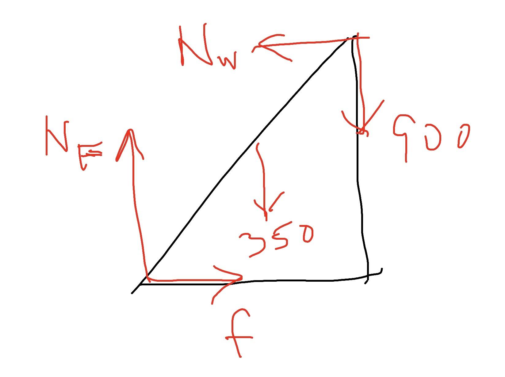

A 6 m ladder weighs 350N and is placed with its lower end on a horizontal floor and its upper end against the wall. The angle between the wall and the ladder is 30°. A man weighing 900N is to climb to the very top of the ladder. The coefficient of friction between the floor and the ladder to avoid the danger of slipping is?

Can you show what you have so far so we know where you're stuck?
I have this diagram, but I'm not sure about this 900 N, on top of the ladder already?
$\sum F_x = 0$, $\sum F_y = 0$, and $\sum \tau = 0$

I forgot there is friction between the wall and the
I forgot there is a friction between the wall and the ladder which is 0.20
Which direction do you think the wall friction acts on the ladder?
