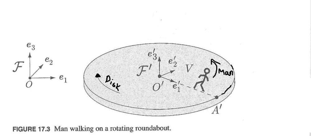

A horizontal disk rotates at an angular speed ##\omega_1## clockwise around its center of mass (which is where the origin of the non-inertial frame lies). A person with a rope is turning counterclockwise at an angular speed ##\omega_2## on that disk. The rope has length ##l_2##. The man himself is at a distance ##l_1## from the origin of the disk and the rope also moves at a height ##h## above the horizontal disk. A stone is attached to the end of that rope, which becomes a pendulum. At ##t=0##, the pendulum is maximally far away from the origin (thus, the origin, the man and the stone stand on a straight line).
a) Find an expression for the speed ##v(t)## of the stone at a given moment ##t## in terms of the Cartesian coordinate system at rest. Choose the origin of such a system to be located at the center of the disk. Choose the ##z## axis to be vertically upwards, the ##x## axis according to the straight line that goes through the stone at ##t=0## and the ##y## axis perpendicular to the previous ones.
b) Suppose the man releases the stone at ##t=0##. Where does the stone fall on the disk?
NOTE:This exercise has been translated from Dutch by Google Translator. Let me know if there's something unclear and we can all discuss about it.

- Picture of the problem (imagine the man has a pendulum):

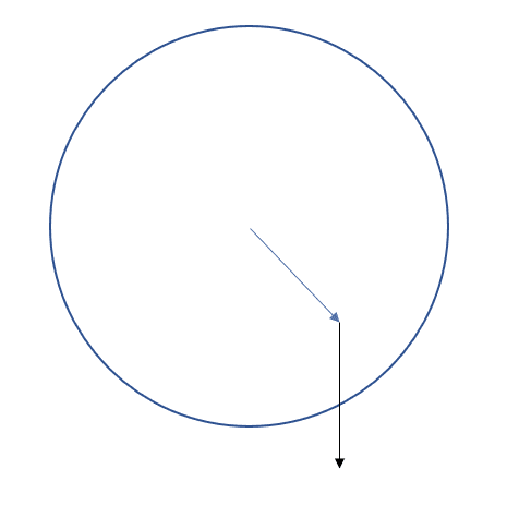

b) Here I guess the exercise is asking for a qualitative answer. I expect the pendulum when released to have the direction of the black arrow:

Again, why? There seems to be enough information.
What kind of information do you think is missing?
JD_PM said:
Because I thought that the man on the merry-go-round would be holding the pendulum at a small angle while rotating.
It says the "rope moves at height h". This implies the stone is moving in a horizontal circle about the man. Now, strictly speaking I don't think that would happen, but if the man is rotating much faster than the disc then this would be a reasonable approximation.
The problem is gravity. Without the disc rotation, we could work out the angle the rope makes to the horizontal; with the disc rotation, it is not obvious that this is constant.
I need to think about that some more.
