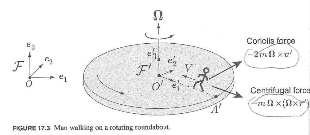

##\mathbf X## is the true force that the roundabout exerts on the man. Relative to the inertial frame, part of the motion of the man is circular motion. So, there must be a centripetal component of force acting on the man. What direction is this in terms of the unit vectors ##\mathbf {\hat e'_1}##, ##\mathbf {\hat e'_2}## , and ##\mathbf {\hat e_3}##?
Also, from the point of view of the inertial frame, the speed of the man due to rotation decreases as he walks toward the center (from point a to point b in the figure below).
So, there is a component of acceleration opposite to the arrows shown in the figure. What direction is this in terms of the unit vectors ##\mathbf {\hat e'_1}##, ##\mathbf {\hat e'_2}## , and ##\mathbf {\hat e_3}##?
Likes JD_PM and vela
When you said true you meant net, isn't it?
I expect the centripetal component of force acting on the man (wrt the inertial frame) to have the form:
$$\vec X_c = -A \ \mathbf {\hat e_1}$$
And I expect the centripetal component of force acting on the man (wrt the non-inertial frame) to have the form:
$$\vec X_c = -A \ \mathbf {\hat e'_1}$$
I've taken outwards direction as positive. The man is dragged inwards.
Thanks for the diagram.
Here what you are asking (if I am not mistaken) is for the direction of the tangential acceleration.
Thus, I expect the tangential component of force acting on the man (wrt the non-inertial frame) to have the form:
$$\vec X_t = - B \ \mathbf {\hat e'_2} $$
Mmm so with this exercise you tried to show me that the -ive sign in front of the ##\mathbf {\hat e'_1}## is due to the centripetal acceleration dragging the man inwards and that the -ive sign in front of the ##\mathbf {\hat e'_2}## is due to the tangential acceleration dragging the man to his left, didn't you?
Note ##A## and ##B## are constants.

The last term, the centripetal force is towards the centre, but the ##e_1## vector points away from the centre. So, that term is negative.
The middle term, the Coriolis force, is ##\pm## depending on the convention for ##\Omega##. That said, what is physically meaningful is the direction of the Coriolis force relative to the directions of rotation and the man's velocity. If the man turns round and walks outward, then the Coriolis force changes direction.
That is worth thinking about.
Assuming here by "Coriolis force" we mean the real force on the man by the floor.
I agree (by the way, didn't you mean ##\mathbf {\hat e'_1}##?)
Let us take counterclockwise direction as positive. The Coriolis force points to the right of the motion of the object then (https://en.wikipedia.org/wiki/Coriolis_force)
Yes, the primed vector.
With the centrifugal/centripetal force we have a nice convention that one is the fictitious force and one is the real force. With the Coriolis force, we have only the convention that this is the fictitious force. I would tend to use "real" Coriolis force to identify the real force needed to keep the man on a straight path.
The thing to note is that as the man moves in his AM is decreasing ##L = m\Omega r^2##. Without any lateral forces, he should be spinning faster than the merry-go-round. Therefore, he needs to push in the direction of rotation (i.e to his right) , and the the merry-go-round must react in the direction against the rotation (i.e. to his left). That's the real force, whatever you choose to call it.
If he walks outwards, the opposite is true as his AM is increasing.
Likes JD_PM

In the non-inertial, rotating frame, the net force on the man is zero since the man has no acceleration in this frame. So, the net force in the ##\hat e'_1## direction is zero. The centripetal force due to friction is canceled by the fictitious centrifugal force.
Likewise, in the rotating frame, the component of the friction force in the ##-\hat e'_2## direction is canceled by the fictitious Coriolis force which is in the ##+\hat e'_2## direction.
The gravitational force is canceled by the normal force.
Likes JD_PM
