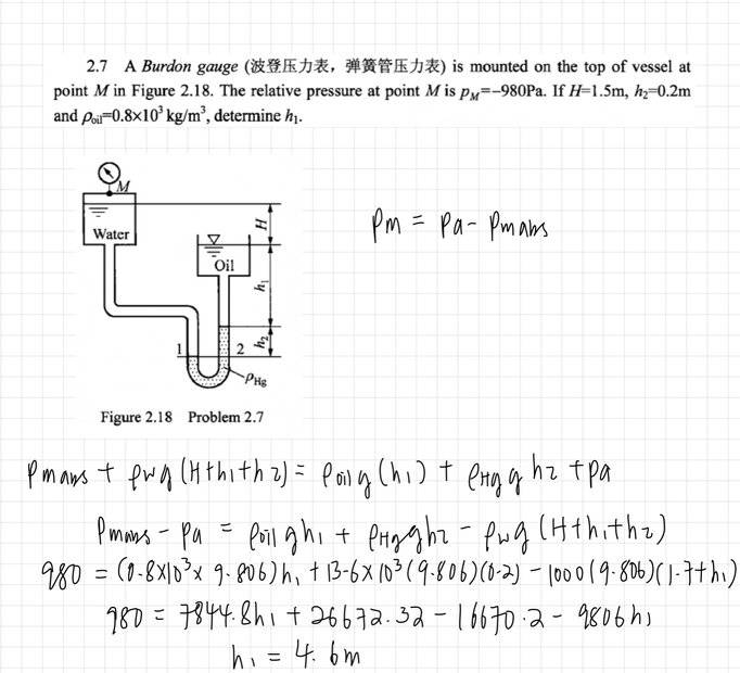

A Burdon gauge is mounted on the top of the vessel at point M . The relative pressure at M is -980Pa, determine h1 if H=1.5m, h2=0.2m
Pm=Pa- Pmabs
The correct answer is 5.6m, not sure where I made the mistake.
##P_{M gauge}=P_{atm}-P_{M abs}##?
Doesn't look right to me.
I get ##P_{Mabs}=p_{atm}+P_M##
