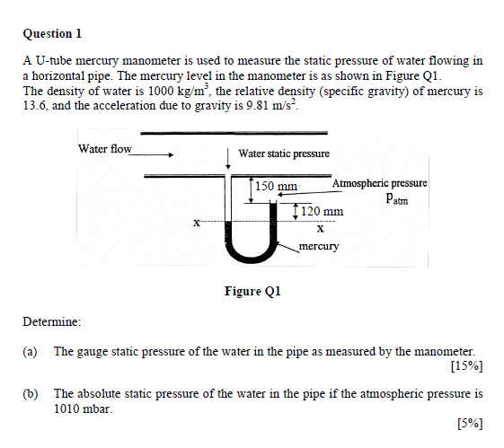

Manometry to determine static pressure in a pipe.

Please see attached for question and attempted solution,
Im pretty sure this is correct, can anybody confirm?

pB needs atmospheric pressure added since A is open to the atmosphere.
asks for gauge pressure? but thanks for your contribution
Right. Hadn't noticed.
