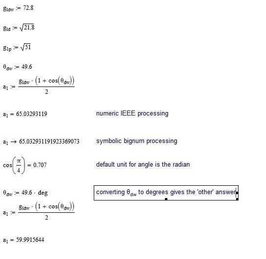

Hi all!
I have tried to calculate a1 using Maple as shown here: http://screencast.com/t/iV1XwJ1CXiqU
The problem is when I do this exact same calculation by hand with the exact same values I always end up with 59.99 but Maple gets 65.03?
How can there be such a big difference?
Thanks!
What are the units of theta, degrees or radians?
The following Mathcad 15 implementation makes it look like Maple's 'correct' answer uses radian measure for θdw and you've used degree measure.

Wow thanks so much guys that's been driving me crazy! I can't believe I never figured that out! You guys are lifesavers :)
