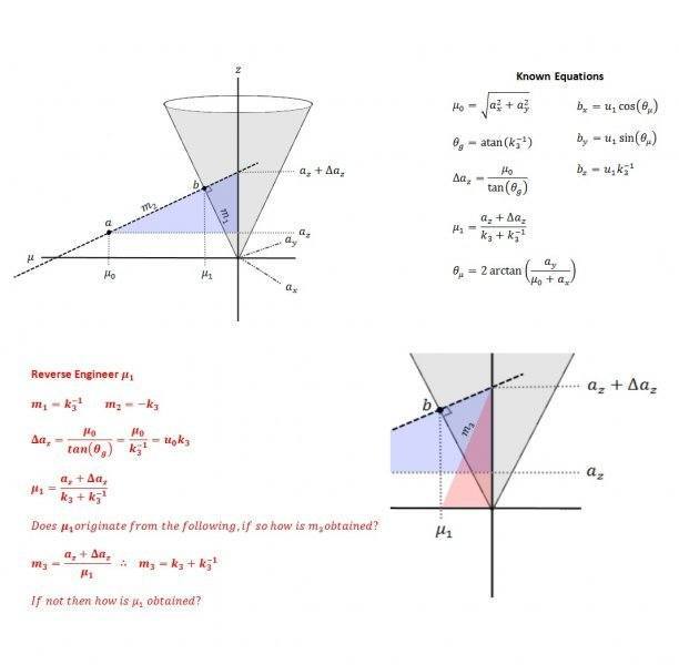

In summary, the solution for obtaining u1 is achieved by solving simultaneous equations of perpendicular straight line functions (m1 and m2) in the top diagram, not through the use of m3 as shown in the bottom diagram.
mamort
Can someone please look at the diagram below and tell me how u1 is obtained. If it is through the use of m3 please explain how the gradient m3 is obtained.

Thanks for monitoring this problem, I have now found the solution which is achieved by solving simultaneous equations of both straight line functions (m1 and m2) that are perpendicular in the top diagram above. The bottom diagram is NOT how the solution is achieved.
