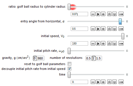

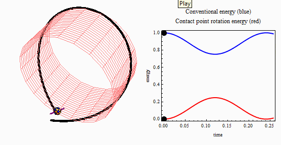

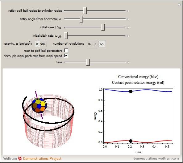

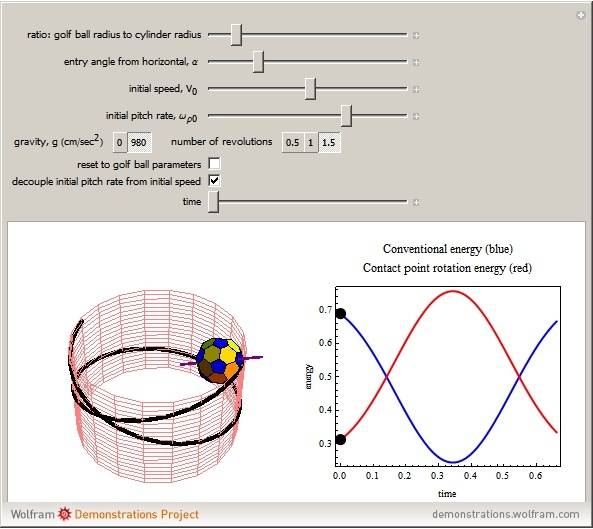

Here is a demonstration on this:
http://demonstrations.wolfram.com/RollingBallInsideACylinder/
They consider a vertical cylinder, where without disspative forces the rolling ball thrown in from the top, would go up and down and never reach the bottom end. The same applies to a horizontal cylinder. The torque perpendicular to the surface at contact point, that makes the ball turn around is called "Coriolis torque".
They also give this reference:
http://ajp.aapt.org/resource/1/ajpias/v74/i6/p497_s1

I hope we also all finally agree that the angular kinetic energy of a rolling marble is not negligible compared to its linear kinetic energy. And that gyroscopic effects play a role here. I chose some parameters closer to the description in the OP:
Here the applet again:
Yes we can and the animations are well done.
