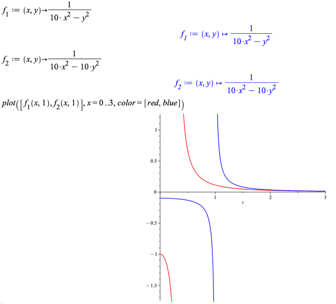

Here is a visual of this
In the plots above, I assume ##y=\omega_d=1##. For any ##\omega_0>1## we see that the red line is below the blue line (this isn't totally clear from the plot but should be from the equations barring a mistake).
I think it may make sense to look at the absolute values
Note that the blue curve represents, for each ##\omega_0##, one tenth the amplitude of the initial vibration for that ##\omega_0##.
The red curve represents, for each ##\omega_0##, the amplitude when we multiply ##k## by 10 (ie, when we multiply ##\omega_0^2## by 10).
Near resonance, the original amplitude and one tenth of it becomes very large.
The resonance of the spring with a ten times higher ##k## happens at a much lower natural frequency.
We need to get away from this natural frequency for the amplitude to be below ##1/10## the original amplitude.

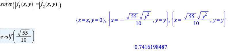

In fact, the point where the two curves cross is at ##\omega_0\approx 0.74##.
In general (ie, when we don't assume, as above, that ##\omega_d=1##) the point where the absolute values of the amplitudes cross is
$$0.74\omega_d,\ \ \ \ \ \ \text{assuming}\ \omega_d>0$$
For clarity, this came from
That is, given a driving frequency and a natural frequency (ie given an initial spring), multiplying the spring constant by 10 reduces the amplitude below 1/10 the original amplitude if ##\omega_0>0.74\omega_d##.
If this condition is not met, then we would need to multiply ##k## by a larger number.
As a final point, what my original calculation did, in terms of the plots above, was the following.
Given ##\omega_0## and ##\omega_d##, draw a vertical line in the plot above at ##\omega_d##. Then, what is the exact factor to multiply ##k## by so that when we plot ##\frac{A_0}{k\omega_0^2-\omega_d^2}## the resulting (red) curve crosses the point where the vertical line crosses the plot of ##\frac{1}{10}\frac{A_0}{\omega_0^2-\omega_d^2}##, ie the blue curve.
