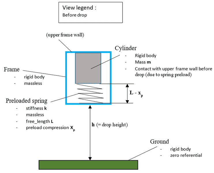

Hello everybody,
I'm trying to figure out how to calculate xadd, the additional compression of a preloaded spring (initially compressed of xp) on which a mass is dropped from a height "h".
I also wonder :
- if the final compressed spring length is the same with or without preload ?
- if the spring receive an additional compression xadd >0 whatever the drop height ? (even at h=0.001 ?)
I have some remembering about my academic studies (Energy conservation laws applied to spring) but I feel quite uncomfortable since I did not practice for a long time. Thanks a lot for any kind of help.

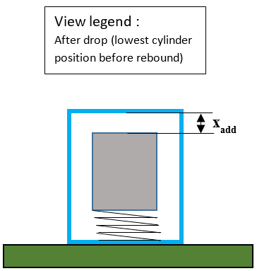

Consider the energy of the cylinder, just before the frame hits the ground:
E1 = m*g*(L-xp) + ½*m*v2
Now consider the energy, E2 , when the cylinder has been brought to a halt ( last figure ).
The difference in energies: ( E1 - E2 ) must have been absorbed by the spring, so:
( E1 - E2 ) = xadd Fspring(x) dx

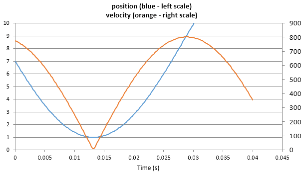

to confirm the results, here is what I got using a mechanism simulation software :
(velocity as initial condition of the dynamic study (just before hit) : v = √(2*g*h) = 776.067 mm/s)
Good to see that lowest reached position is 1mm according to minimal spring height used is previous calculation (contiguous wire)
I hope the results are not accidentally good :nb).
