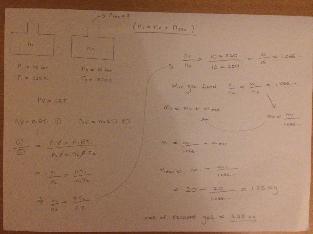

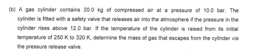

Work out the mass of gas released from cylinder
PV = nRT
This is the problem below that I have tried doing
I ended up getting the mass of gas ejected to be 1.25kg from doing the following
Would you say this is a reasonable value to get
Thanks in advance!
It looks reasonable to me.
