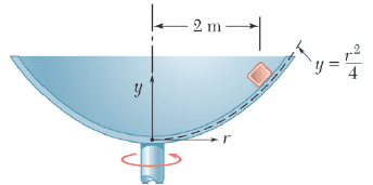

A 3-kg block is at rest relative to a parabolic dish which rotates at a constant rate about a vertical axis. Knowing that the coefficient of static friction is 0.66 and that r = 2 m, determine the maximum allowable velocity v of the block.
Picture attached below
F = ma
I began by drawing a FBD on the mass:
W: Weight, pointing vertically downwards
N: Normal, pointing perpendicular to the surface
f: Friction, pointing 90 degrees clockwise from N.
From there I calculated the angle from the origin:
y = (2^2)/4 = 1
Θ = tan^-1(1/2), with the adjacent arm being 2, vertical arm being 1, and the hypotenuse being sqrt5
Then I determined that the net force should be horizontally pointed inwards, with the formula: F = mv^2/r
So Fy is 0, meaning:
(3)(9.81) = 0.66N[1/sqrt(5)] + N[2/sqrt(5)]
--> N = (29.43sqrt[5])/(2.66)
Now for Fx:
[3v^2]/2 = N[1/sqrt(5)] - 0.66N[2/sqrt(5)]
The problem is this resolves to be:
[3v^2]/2 = -3.54...
which has no solution.
So, what am I supposed to do from here?
y = (2^2)/2 = 1
Where did you get this equation for y? Check the source.
Sorry, I meant to write 2^2/4, but that would actually equal 1.

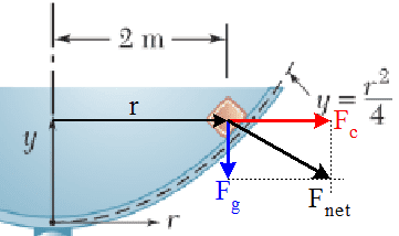

I kind of phased out looking at your solution after I noticed the angle issue. But essentially you need to resolve the centripital and gravitational forces into normal and slope-wise components to continue.
Hint: If you work in the non-inertial frame of reference of the rotating dish you're allowed to speak of centrifugal force as though it were an actual force and use it in your FBD.

Okay, I'm still having difficulty with this. So, what I did was rotate the coordinate system 45 degrees (CCW).
Now, on your diagram I'm mostly confused as to how the Normal and Frictional forces were resolved into one centrifugal force, unless I misunderstood the diagram.
Because in the direction of the tangent, there's no net force, which implies that Fc = W. From there, both W and Fc point in direction of the net force (along the normal axis) which implies:
[3v^2]/[2] = [1/sqrt(2)][2*3*9.81]
From there, v can be solved to be 5.27 m/s, but that was marked as wrong.
So what am I supposed to do with the contact forces?
My diagram does not include the friction force, only the two "external" forces due to gravity and rotation. It shows how they resolve into a net external force. I suppose I should have made that clear. Sorry about that.
You need to resolve that net force into normal force and force along the surface (incline), then include friction (which requires that normal force component) to write the net force acting along the slope.

I still don't know what to do, from here. I'm still confused about the centripetal force (Fc). Is it a result of the other 3 forces (normal, friction, gravity) or is it a 4th independent force resulting from the rotation?
When you move to the rotating frame of reference you can use the centrifugal force in the same way that you use the gravitational force. The only difference is that the centrifugal force is position dependent (radial distance from the axis of rotation). In my figure I've drawn in the gravitational and centrifugal forces that act on the block at its current location. It's up to you to break them down into normal and slope-wise components.

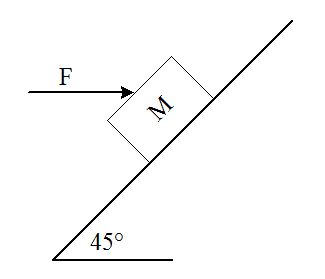

Right. You know the total normal force, so that gives you the frictional force. What is the sum of the tangential forces?
Edit: just noticed you have it backwards. I assume you meant f=0.66N.

Note that the problem is equivalent to one where you have a block on an incline with static friction and a horizontal force being applied to the block. You are to determine what the maximum force F can be before the block starts moving up the slope.

RoyalFlush100 said:
acting in the same direction as the friction
Friction acts to oppose relative motion of surfaces in contact. If the velocity is too great, which way will the block move?
Thank you guys so much, I finally got the answer. Sorry that took so long for me to figure out.
