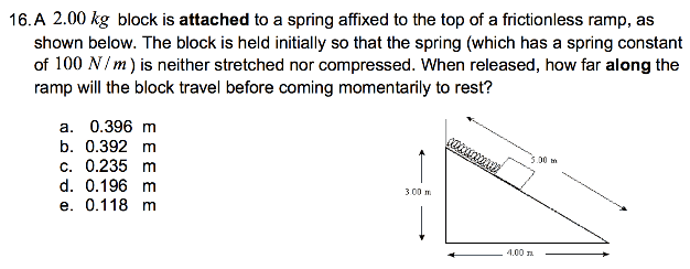

I honestly don't know where to start. First I tried kx = mgsin(tan-1 (3/4))) and got the answer E, which is wrong. Then I tried using energy, mgh = 1/2kx^2 which resulted in an answer that wasn't on the list. Any ideas on how to begin?
Likes Delta2
At any point after letting go of the mass,
energy stored in spring + potential energy + kinetic energy = constant. (Why?)
Because total mechanical energy of the system is conserved?
Edit: nvm I figured it out!
Why is ##kx = mg \sin \theta## wrong here?, ##\theta## the inclination of ramp.

Since this is quite an old thread, i suppose i can give the answer, it is C. 0.235m

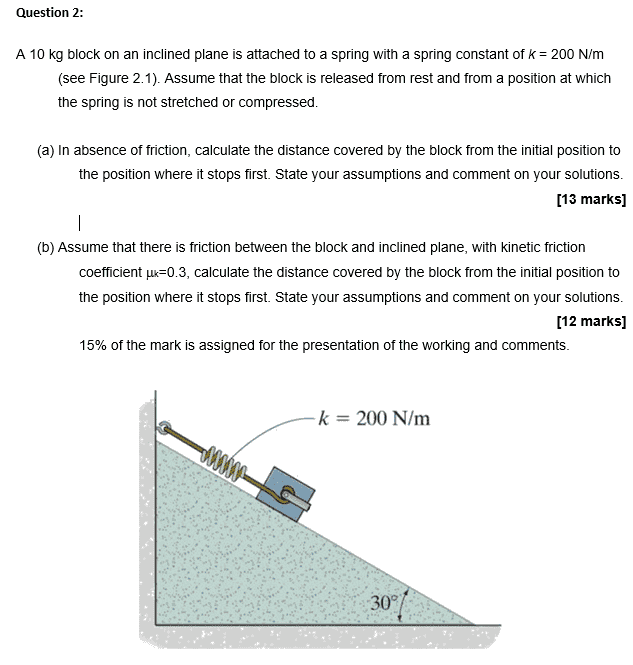

So for this one, would you use the same method? I'm somehow getting 0.1178 for 2b and 0.245 for 2a.
I did it and i get 0.5m for a) and 0.24m for b). used g=10m/s^2. Please post your workings here if you want me to comment on them.

nope. For a) i equal gravitational potential energy to elastic potential energy of the spring.
for b) i use work energy theorem $$W_{TOTAL}=\Delta K$$. We know that $$\Delta K=0-0$$ since the block starts from rest, and the end position is also one with zero speed. So calculate the total work and set it to zero. You ll have one equation with one unknown, the displacement of the spring x.
Better use work energy theorem for a) too . The logic is the same as for b), it is just that the total work is different in each case.
