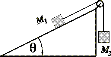

M1 and M2 are two masses connected as shown.
(M1 on hypotenuse of triangle, M2 on right side, (adjacent to right angle)) (Pulley at corner of them, Angle Theta is on the opposite corner)
The pulley is light and frictionless. Find the mass M1, given that M2 (4.50 kg) is moving downwards and accelerates downwards at 3.09 m/s2, that θ is 20.0°, and that μk is 0.450.
The total force (which is the total mass times the acceleration) is equal to the sum of the forces. The normal force is NOT simply "m1g"--WHY?

The picture should be attached now.

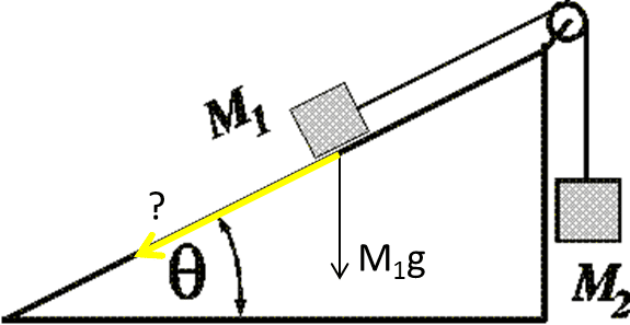

Weight is acting downwards but we need to find what effect does it have along the inclined plane. For that you need to take component of mg along the inclined plane. Can you do that? :smile:
W = cos20 * T
cassienoelle said:
W = cos20 * T
That's completely absurd.
I think you are not able to picture out what i am talking about. Ok here's a picture:-
Can you find the component (the yellow arrow)?
No, I can't.

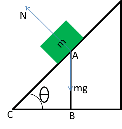

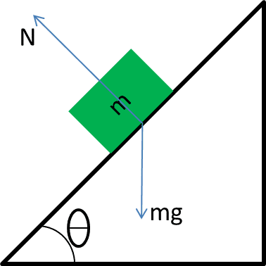

Here's the explanation:-
Let us consider an object of mass m kept on an inclined plane as shown in the figure.
The blue arrows indicate forces. Now to find the component along the inclined plane, draw a straight line as shown in the figure. The straight line is along the force mg.
Now in triangle ABC, angle BAC is 90-[itex]\theta[/itex]. Now its easy to have the components. The components are shown in the figure below.
So we have found out the components.
So now can you tell me what’s the normal reaction force here?
(Ask if you have any doubts, because this is a very important concept, don't miss this one)
