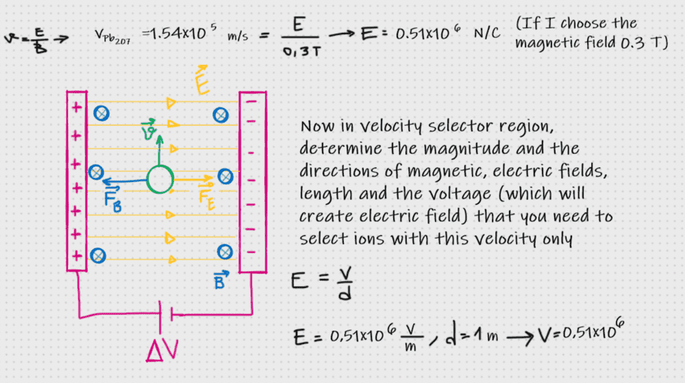

You're right. The original problem didn't ask you to use the neutron mass, it just said, "The mass difference between two isotopes is sometimes just a neutron mass. The spectrometer should separate them very well."
