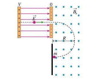

A Mass-spectrometer consists of cylindrical capacitor with inner radius R1=4.5 cm and outer radius R2=5.1cm. Ions enter the mass-spectrometer through a narrow slit which is situated in between the capacitor plates as shown on the picture. Uniform magnetic field B=0.4 T is applied parallel to the capacitor’s axis, direction out of the plane. Find potential difference that should be applied between capacitance’s plates in order for the lithium ion Li+7 (such ions have charge +e, mass 7m, m=1.67*10-27 kg) to go around the middle section of the capacitor, i.e. on the circle of R= 4.8 cm. Energy of incoming ions is 1200 eV. By how much the potential should be changed in order for lithium ions Li+6 to go around the same trajectory?

Can you show a picture? I do not know what you mean on "down", towards the centre of away from it, and which plate is A and which is B?

For some reason I can't get the picture to show up. I tried multiple ways.
The picture is rather simple, it is a rainbow/half donut shape with a path going through which is designated as R (goes from the origin to the path). R1 is the radius of the bottom of the rainbow from the origin and R2 is the radius from the origin through the entire "rainbow". The particle is moving to the right and B is pointing out of the page.
Is that understandable?

This is similar except the semicircular chamber is closed flip the picture counterclockwise 90 degrees.
So downward means toward the centre. OK.
