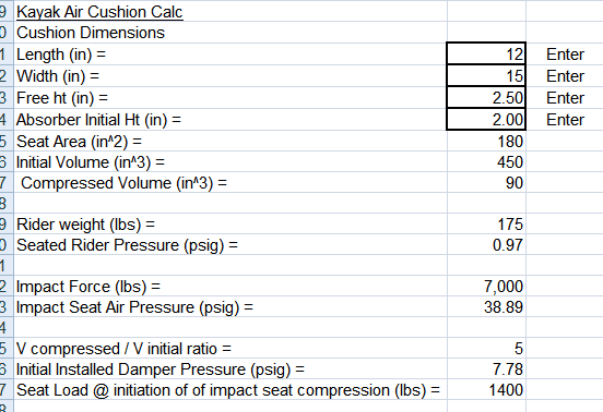

I had some extra time today, so I developed the attached Excel calculation that I believe will help you with your kayak seat damper and spring issue. There are several steps shown in this program that could be combined; but, I entered them step-by-step so you can see the process.
Edit: Technically this calculation is based upon a straightforward energy translation and absorption basis.
(I originally misspoke and used the term "creation of energy" which is a term that sadly misused far to many times.)
If you have any questions just post them.

WW Kayaker,
Glad to find out you are still with,us. As I mentioned above, I have been investigating the concept of an under seat air cushion and below is an example of a fully contained air bladder the size of my reference seat. What you should not is the the seat deflection due to a 175 lb rider is negligible and the pressure at the full impact compression is actually very low (40 psig) and it only begins to compress when 1400 lbs of rider impact force (8 G's) is applied.
In working with this and thinking about the car seat I described made me think of pneumatic boat fenders and below is an example of what might be interesting to investigate (or play with) in testing this concept. Each fender is 3.5 in in diameter but the pressure is adjustable so they could be imflated to alow enough pressure to provide a lower seated load ht. What I envision is a number of these lying side by side, each fender is 13" long. Just a thought of maybe something to experiment with at a low cost.

WW Kayaker said:
However, I suspect the water doesn't act like a spring but more like a damper with uniform rate of dampening during the entire impact.
OK, let's model the water as a pure damper, that is ##F= -Cv## where ##C## is a damping coefficient.
We already know the initial velocity upon impact, i.e. ##v_0 = \sqrt{2gh}##. Knowing that ##v = \frac{dx}{dt}## and ##F = m\frac{dv}{dt}##, then:
$$F = mv\frac{dv}{dx}$$
$$-Cv = mv\frac{dv}{dx}$$
$$dx = -\frac{m}{C}dv$$
$$\int_0^d dx = -\frac{m}{C}\int_{v_0}^0 dv$$
$$d = \frac{m}{C}v_0$$
Thus we can estimate ##C## if we know the distance ##d## that the kayak sinks in:
$$C = \frac{mv_0}{d}$$
The maximum damping force will be at maximum velocity, which is at ##v_0##:
$$F_{d\ max} = C v_0 = \frac{m}{d}v_0^2 = \frac{2mgh}{d} = \frac{2Wh}{d}$$
For ##W= 175\ lb##, ##h = 20\ ft## and ##d= 6\ in##, then ##F_{d\ max} = 14\ 000\ lb##.
What difference will adding a spring in series do? Assuming the ideal case where the spring compresses completely before the kayak begins sinking:
$$v_0 = \sqrt{2gh - \frac{K_s}{m}x_s^2}$$
and
$$F_{s\ max}= K_s x_s$$
$$F_{d\ max} = \frac{m\sqrt{2gh}}{d}\sqrt{2gh - \frac{K_s}{m}x_s^2}$$
The spring constant necessary to achieve a compression of ##2"## without bottoming out is ##5930\ lb## which will give ##F_{s\ max} = F_{d\ max} = 11\ 860\ lb ##, same as with the 2 springs in series. With any other spring constant, either ##F_{s\ max}## or ##F_{d\ max}## will increase (up to ##14\ 000\ lb##).
I thought that was an interesting result. I guess it means that there is a maximum value for the energy that you can absorb with a spring under the seat, no matter how the energy will be dissipated afterward.
Likes JBA
