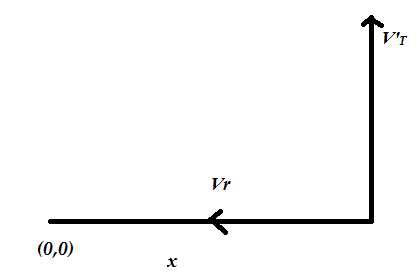

A particle is been acted by a central force exerted by a sphere of mass 'M' at a distance 'xo' initially from the particle (of same mass). At t=0 the particle has velocity Vt perpendicular to the line joining the particle and the center of the sphere. Find the time at which it collides with the sphere.
It is given that ##x_{0}=1m## and ##V_{t}=1m/s##
##F=\frac { k{ M }^{ 2 } }{ { R }^{ 2 } } ##
Also it is given that ##4K=1##
I first converted the two body problem to a single body problem using reduced mass concept.
Let a reduced mass be placed at distance 'xo' from point (let it be at origin) exerting Force = ##F=\frac { k{ M }^{ 2 } }{ { x }_{ o }^{ 2 } } ##
At any general position let the separation between induced mass and the origin be x. Let the radial and tangential velocity at that instant be ##{ V }_{ r }## and ##{ V }_{ T }^{ ' }##
From conservation of Angular momentum.
##\mu { x }_{ o }{ V }_{ T }\quad =\quad \mu x{ V }_{ T }^{ ' }##
##{ V }_{ T }^{ ' }\quad =\quad \frac { { x }_{ o }{ V }_{ T } }{ x } ##......1
Now from Newton's second law.
##\frac { K{ M }^{ 2 } }{ { x }_{ }^{ 2 } } \quad -\quad \frac { \mu ({ V }_{ T }^{ ' })^{ 2 } }{ x } \quad =\quad \mu { a }_{ r }##
##\frac { K{ M }^{ 2 } }{ { \mu x }_{ }^{ 2 } } \quad -\quad \frac { ({ V }_{ T }^{ ' })^{ 2 } }{ x } \quad =\quad { a }_{ r }##
##\frac { K{ M }^{ 2 } }{ { \mu x }_{ }^{ 2 } } \quad -\quad \frac { ({ V }_{ T }^{ })^{ 2 }{ x }_{ o }^{ 2 } }{ { x }^{ 3 } } \quad =\quad -\frac { { V }_{ r }d{ V }_{ r } }{ dx } ##
##-\frac { K{ M }^{ 2 } }{ { \mu x }_{ }^{ 2 } } dx\quad +\quad \frac { ({ V }t)^{ 2 }{ x }_{ o }^{ 2 } }{ { x }^{ 3 } } dx\quad =\quad -{ V }_{ r }d{ V }_{ r }##
Integrating
##\frac { K{ M }^{ 2 } }{ { \mu x } } \quad -\quad \frac { { V }t^{ 2 }{ x }_{ o }^{ 2 } }{ { 2x }^{ 2 } } \quad =\quad \frac { { V }_{ r }^{ 2 } }{ 2 } +C##
at, ##x\quad =\quad { x }_{ o }## , ##{ V }_{ r }\quad =\quad 0##
so, ##C\quad =\quad \frac { K{ M }^{ 2 } }{ \mu { x }_{ o } } -\quad \frac { {V_ { t }}^{ 2 } }{ 2 } ##
on putting 'C'
##\frac { 2K{ M }^{ 2 } }{ \mu } (\frac { 1 }{ x } -\frac { 1 }{ { x }_{ o } } )-\quad { V }_{ t }^{ 2 }\quad (\frac { { x }_{ o }^{ 2 } }{ x } -1)\quad =\quad { V }_{ r }^{ 2 }##
As ## \mu=M/2## so
##4K{ M }^{ 2 }\quad (\frac { 1 }{ x } -\frac { 1 }{ { x }_{ o } } )-\quad { V }_{ t }^{ 2 }\quad (\frac { { x }_{ o }^{ 2 } }{ x } -1)\quad =\quad { V }_{ r }^{ 2 }##
##\frac { 1 }{ x } -\frac { 1 }{ { x }_{ o } } -\quad (\frac { { x }_{ o }^{ 2 } }{ { x }^{ 2 } } -1)\quad =\quad { V }_{ r }^{ 2 }##
##\frac { 1 }{ x } -\frac { 1 }{ { x }_{ o } } -\frac { { x }_{ o }^{ 2 } }{ { x }^{ 2 } } +1\quad =\quad { V }_{ r }^{ 2 }##
On substituting the value of ##x_{0}## I got
##\frac { 1 }{ x } -1-\frac { 1 }{ { x }^{ 2 } } +1\quad =\quad { V }_{ r }^{ 2 }##
##\sqrt { \frac { 1 }{ x } -\frac { 1 }{ { x }^{ 2 } } } =\quad \frac { -dx }{ dt } ##
##\sqrt { \frac { x-1 }{ { x }^{ 2 } } } =\quad \frac { -dx }{ dt } ##
##\int _{ 0 }^{ t }{ -dt\quad =\quad \int _{ { x }_{ 0 } }^{ R }{ \frac { xdx }{ \sqrt { x-1 } } } } ##
I don't know if I am right till here or not . It would be nice if anyone could help.
Thank You!
Should this read ##4KM = 1##?
It seems to me that the signs are wrong on the left. Also, I'm assuming that the symbol ##a_r## stands for ##\ddot{r}## and not the full radial acceleration in polar coordinates. The ##r \dot{\theta}^2## part of the complete radial acceleration is taken care of in your second term on the left (if the sign is corrected.)
I don't see how you got the negative sign on the right side in the last equation above.
You changed the signs on the left, but you didn't change the sign on the right.
Integrating
You dropped the negative sign on the right that was there in the previous equation.
All of these apparent sign errors seem to cancel so that I agree with what you have at this point!
As ## \mu=M/2## so
I don't think the M should be squared on the left. But you made up for that later.
I agree with the rest of your work and your final integral expression for the time looks correct. (I could have overlooked something or made some errors myself.)
EDIT: I now see that some of my disagreements with your signs are due to the fact that you are taking the positive radial direction for ##a_r## to be centripetal rather than centrifugal.

TSny said:
Should this read ##4KM = 1##?It seems to me that the signs are wrong on the left. Also, I'm assuming that the symbol ##a_r## stands for ##\ddot{r}## and not the full radial acceleration in polar coordinates. The ##r \dot{\theta}^2## part of the complete radial acceleration is taken care of in your second term on the left (if the sign is corrected.).
Yes, there ##a_{r}## stands for radial acceleration. .
I don't see how you got negative sign in the right side of you equation
There should be -ve sign with ##dx/dt## because ##x## is decreasing with time but acceleration (radial) is ##dv_{r}/dt## and velocity(radial) is increasing with the passage of time there shouldn't be -ve sign. Am I right?
You dropped the negative sign on the right that was there in the previous equation..
Typo. Sorry :oops:

One can start with conservation of energy. What is the energy of the system with the given initial conditions - distance between the masses 1 m, one mass stationary, the other has 1 m/s velocity perpendicular to the line connecting the masses, and 4KM=1?
Good suggestion. Looking at the energy, it appears that the numbers given in the problem lead to no solution. The two objects will continue to separate from one another for all time.
You can also see that there is a problem by looking at Satvik's last equation where the expression ##\sqrt{x-1}## occurs in the integrand. In order for the particle to collide with the sphere, ##x## would need to become less than ##x_0 = 1 m##, which makes the square root imaginary.
The energy of the virtual particle with the effective mass M/2 has zero energy, which corresponds to a parabolic orbit in the CoM frame of reference.
By the way, the integral ##\int \frac{x dx}{\sqrt{x-1}} ## can be solved (for x>1) with substituting ##u=\sqrt{x-1}##
Oh! The numbers didn't worked as planned!
I tried to find the the maximum value of velocity with which reduced mass can be projected so that make it's way up to the distance R from the origin.
If it would projected with velocity(tangential) such that force acting on the reduced mass is enough to provide required centripital force then reduced mass will revolve in a circular orbit around the origin.
##\frac { \mu { v }_{ t }^{ 2 } }{ { x }_{ 0 } } =K\frac { { M }^{ 2 } }{ { x }_{ 0 }^{ 2 } } ##
##{ v }_{ t }=\sqrt { \frac { K{ M }^{ 2 } }{ \mu { x }_{ 0 } } } ##
So for ##{ v }_{ t }<\sqrt { \frac { 2K{ M }^{ } }{ { x }_{ 0 } } } ## the particle surely collides with the sphere. Right??
It depends on the radius of the sphere. The particle moves along an ellipse if the energy is negative, and the shape of the ellipse is not influenced by the size of the sphere.
