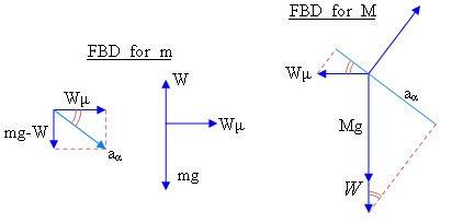

3) The first is FBD for M and the second is for m:
$$\left\{ \begin{array}{l} [W+Mg]\sin\alpha=Ma_\alpha \\ mg-W=ma_y=ma_\alpha\sin\alpha \end{array}\right.~~\rightarrow~~a_\alpha=\frac{(M+m)\sin\alpha}{M+m\sin^2\alpha}$$
Likes PeroK
If you add "g" somewhere, you've got it!
$$\left\{ \begin{array}{l} [W+Mg]\sin\alpha=Ma_\alpha \\ mg-W=ma_y=ma_\alpha\sin\alpha \end{array}\right.~~\rightarrow~~a_\alpha=\frac{(M+m)\sin\alpha}{M+m\sin^2\alpha}g$$

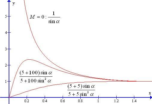

EDIT: The behavior of ##a_\alpha## for ##\alpha##→ 0 is very different for M = 0 compared to M ≠ 0 with M << m. Graphing ##a_\alpha## vs ##\alpha## for various M/m values is useful. I think this has something to do with childhood memories of squeezing a slippery watermelon seed between thumb and forefinger to launch the seed across the room (not at anybody of course :oldeyes:).
TSny said:
The behavior of ##a_\alpha## for ##\alpha## → 0 is very different for M = 0 compared to M ≠ 0 with M << m. Graphing ##a_\alpha## vs ##\alpha## for various M/m values is useful
I will try and post here the graphs
all the graph's results must be multiplied by g, the gravity constant.
I don't understand why, for M=0, aα tends to infinity. it must be a mistake of mine in the graph.
Karol said:
https://www.physicsforums.com/attachments/106086 all the graph's results must be multiplied by g, the gravity constant.
##M \rightarrow 0## is equivalent to ##m >> M##
PeroK said:
##M\rightarrow 0## is equivalent to m>>M
Why the acceleration, parallel to the slope, as ##\alpha\rightarrow 0##, tends to infinity? no matter what the sizes of m and M are they must stay in place, ##a_\alpha\rightarrow 0##, since it is almost a flat table that they lie upon
In the case ##M \rightarrow 0##, ##m## is much larger and squeezes ##M## and shoots it out like the watermelon seed in post #22. The limit of this as ##\alpha \rightarrow 0## is 0 for any finite ##m## and ##M##.
Taking ##M = 0## and ##\alpha \rightarrow 0## breaks the maths, which can happen.
