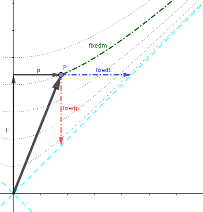

I would argue that ##E^2 = p^2 + m^2## is not a definition of ##m##.
Rather, it expresses the relationship (a constraint) between ##E## and ##p## (an observer's components of the 4-momentum of that particle).
Logically speaking:
Given ##P^a## and the metric ##g_{ab}##, we can form ##P^aP^b g_{ab}## and call it ##m^2## (in the +--- signature)--this defines ##m##.
Next, if we are then given an observer's timelike 4-velocity ##t^a##, we can then define the components of ##P^a## (E and p) for that observer... and see that they are constrained by the square-norm of ##P^a##.
(For another observer and her 4-velocity, we get another set of components (E' and p') that are constrained by an analogous relation.)
Yes, and if you write down ##P^a P^b g_{ab}## in an inertial frame, it is ##E^2 - p^2##. I was assuming that had been done, but you're right that this step should be made explicit.
This method also makes the commonality with the null/lightlike case easy to see. For that case, ##P^a P^b g_{ab} = 0##.
This also takes care of the possibility of ##E < p##, which I mentioned in my response to MisterT; that would require the vector ##P^a## to be spacelike. We can either rule that out a priori, or consider the possibility of tachyons and work out the consequences.

My point is that the 4-momentum and its (invariant) mass m (using the metric) is primary, independent of observer. The role of the observer (which leads to his decomposition of ##P^a## into E and p according to him) is secondary.
Geometrically, the objects (vector and its magnitude (using the metric)) are primary; components of objects are secondary.
Yes, agreed.
