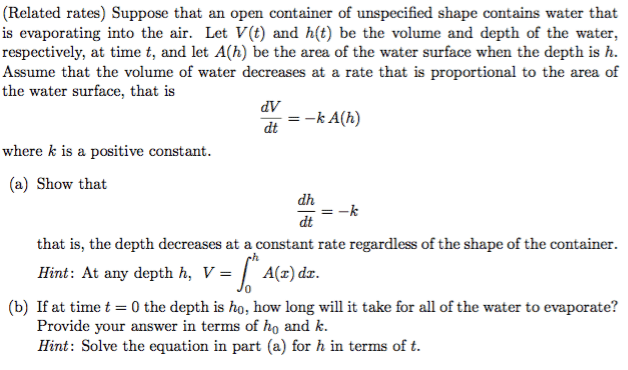

Hi Community,
I have the following problem and I am completely stuck. I really struggle to get my head around how to break down these questions into chunks that I can then apply the math to.
From what I can see so far, I have a to be able calculate the surface area at any height to get the volume and therefore somehow link this to time and that the volume of the water is decreasing proportionally with the surface area.
Many thanks for your time in advance.
Cheers Nemo.
For part a), take the given hint:
\(\displaystyle V=\int_0^h A(x)\,dx\)
and differentiate both sides w.r.t $h$...what do you get?

Let's begin with:
Now, if we differentiate both sides w.r.t $t$ (not $h$ as I originally said, although that would work too), we get:
\(\displaystyle \d{V}{t}=\frac{d}{dt}\int_0^h A(x)\,dx=A(h)\d{h}{t}\)
Now, use \(\displaystyle \d{V}{t}=-kA(h)\) and solve for \(\displaystyle \d{h}{t}\). :D

Okay, for part b) we are being asked to solve the IVP:
\(\displaystyle \frac{dh}{dt}=-k\) where \(\displaystyle h(0)=h_0\)
Solving this IVP will give us $h$ as a function of $t$, which we can solve for $t$ and then set $h=0$ to determine the time at which the container is empty. So, what I would do to solve the ODE is integrate both sides with respect to $t$ (replace the dummy variables of integration), using the initial and final conditions as the limits of integration:
\(\displaystyle \int_{h_0}^{h(t)}\,du=-k\int_0^t\,dv\)
What does this give us after applying the FTOC?

Here is what I had in mind:
If we continue from here...
We then obtain (by using the anti-derivative form of the FTOC):
\(\displaystyle h(t)-h_0=-k(t-0)\)
Now, solving for $t$, we obtain:
\(\displaystyle t(h)=\frac{h_0-h}{k}\)
When all of the water has evaporated, we must have $h=0$, and so the time it takes for the water to evaporate is:
\(\displaystyle t(0)=\frac{h_0}{k}\)
