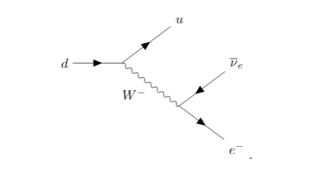

I would like to consider the interaction terms in the Standard Model which allow the following decay process:
The only interaction terms in the Standard Model which allow this decay process are contained in the charged current interactions:
$$\mathcal{L}_{cc}
= ie_{W}\big[W_{\mu}^{+}(\bar{\nu}'_{m}\gamma^{\mu}(1+\gamma_{5})e'_{m} + V_{mn}\bar{u}'_{m}\gamma^{\mu}(1+\gamma_{5})d'_{n})
+ W_{\mu}^{-}(\bar{e}'_{m}\gamma^{\mu}(1+\gamma_{5})\nu'_{m} + (V^{\dagger})_{mn}\bar{d}'_{m}\gamma^{\mu}(1+\gamma_{5})u'_{n})\big].$$
1. Is the vertex between the quarks only allowed by the term ##ie_{W}W_{\mu}^{+} V_{mn}\bar{u}'_{m}\gamma^{\mu}(1+\gamma_{5})d'_{n}##?
2. Is this because the down quark enters the vertex and therefore must not have a bar on top of it?
3. Simialrly, is the vertex between the leptons only allowed by the term ##ie_{W}W_{\mu}^{-} (V^{\dagger})_{mn}\bar{d}'_{m}\gamma^{\mu}(1+\gamma_{5})u'_{n}##?
You are missing minus signs in your projection operators. CC iteractions act on left-handed fields only.
1,2) Yes.
3) No, you need the lepton fields in the operator.
But the left-handed projection operator has a plus sign in the mostly positive metric, does it not? I'm using Cliff Burgess's textbook, although I should be using mostly negative because it is the common usage in the particle physics community.
Right, my bad.
