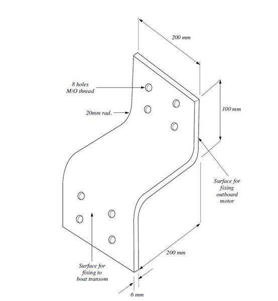

Hi I'm on to the last question for my HNC and having a nightmare trying to work out my best options! Any help would be greatly appreciated!
The bracket show in figure 1 is to be used to mount an outboard motor onto the transom of a boat.
a. suggest two appropriate materials which will require different methods to manufacture the bracket.
b. Discuss the implications of each of the materials and manufacturing processes you have stated in a on the cost and service life of the bracket.
So I think I should be using aluminium as my first material, and stainless steel as my second. My problem is in choosing a manufacturing process. I think low pressure die casting for the aluminium, and maybe die forging for the stainless steel? I'm really not sure! A push the the right direction would be great!

Most "manufacturing" of low volume pieces like this starts with already manufactured metal stock, in the form of flat plates, structural parts, billets, rounds, etc.
I would suggest looking at two processes that use available metal parts to make this bracket, rather than building a foundry to make it. There are processes suitable for 316 Stainless that would be unsuitable for 6061 T-6 aluminum.
For extra credit, can you suggest a simple addition/modification to that bracket to make it *much* stronger? Maybe compare the costs of a modified bracket with the one you show. You could probably use a thinner stock with the modification I have in mind... :smile:
