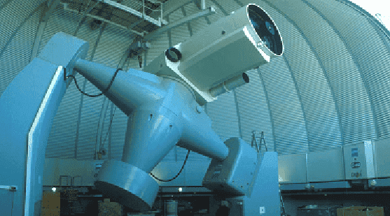

Thank you mfb, that definitely gives me a lot to think on.
In terms of lens diameter mounted on a spacecraft , I guess I am not sure what would be practical and realistic for a future setting. I would assume a 1 m lens with all the equipment/mirrors and some kind of directional maneuvering armature to turn it, it would still be a pretty big protrusion on a vessel's front or underbelly (assuming a 1x4m scope, and 6x6 footprint for some kind of directional apparatus).
(for lack of a better way to demonstrate the issue)
Are there other theoretical ship-mounted designs you are aware of which would create a larger interferometer? Maybe two or more linked lenses spaced apart?
As a bit of background: the protagonist's spacecraft in in the scenario is a military craft maybe 25m across at its widest / 80m long. The closest existing naval analogy would be an Arleigh Burke class destroyer. It would be expected to have some of the best equipment, but its mission is military, so it is very cramped already. Perhaps, lore-wise, this type of ship would normally utilize a reconnaissance probe or vessel ahead of it to identify targets and would have a less extensive "sensor suite".
