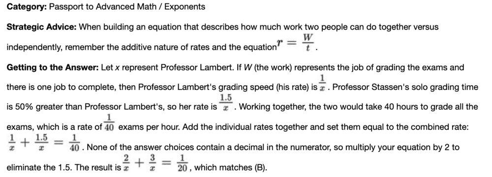

This is their solution. I don't get the part where they are saying Rare of Professor Lmaber = 1.5/t
Shouldn't it be 1/(1.5t) = 2/(3t) ?
First, let's take an example. You should really get into the habit of doing this. a) to see what's going on and b) to get an answer in a specific case.
Let's assume there are 200 exam papers. Together they take 40 hours, so they do 5 an hour between them. That's your ##R'##.
Suppose Stassen does 2 per hour and Lambert 3 per hour (that represents Lambert doing them 50% faster than Stassen). That adds up to 5. And, to check, Stassen would take 100 hours to do them all and Lambert 200/3 hours. 200/3 hours + 50% is 300/3 = 100.
That all checks out. Note that all you need for an example is any job that takes them 40 hours between them. In one sense, that example is a complete solution. Although, whoever marks your exam may not agree with me, so I would stop short of suggesting you do this!
I don't like the book solution. Why ##\frac 1 x## instead of just ##x##? What is ##x## anyway?
In your solution, you need to clarify what ##t## means.

So is ##t = 200/3 ## correct? And once again t is the time taken by Professor Lamber when she grades all the paper by herself (without Professors Stassen's help)
Here's a different take. Both your solution and the book's solution are lacking in analysis. An alternative approach is to be explicit about everything. If the problem were more complicated, then I would do it this way. The key is to miss nothing out. For example:
Let ##W## be the total work to be done. Let ##t_s, t_l## be the time it takes Stassen and Lambert to complete the work on their own. Let ##t## be the time it takes to complete the work together. Let ##r_s, r_l## be the rates at which Stassen and Lambert work. Let ##r## be the rate at which they work together.
That's all your variables defined. Now, we can write down what we know.
We are given the relationship in times:
##t_s = 1.5 t_l##
Use this to get the relationship in rates
##r_s = \frac W {t_s} = \frac W {1.5 t_l} = \frac 2 3 \frac W {t_l} = \frac 2 3 r_l##
Note that this proves that the rates are in inverse proportion to the times. I think the book actually assumes you can just write this down. But, there's no harm in checking it out.
And so on ...
