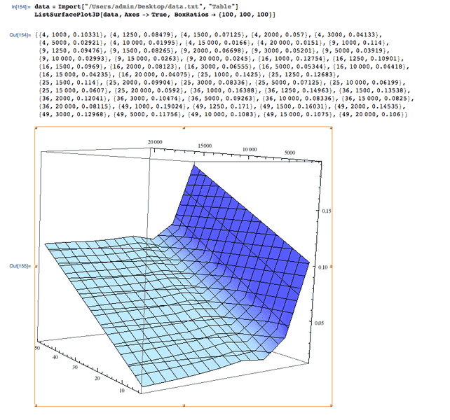

Hi there,
I just began using Mathematica today and I was wondering if there is a way to make the program generate an equation of a surface given a 3d array?
What I need it to do is to give me an equation of the surface so that given any two variables I can find the value of the third one.
Any advice will be highly appreciated.
Here is a screenshot of what the surface looks like:
And here is the array:

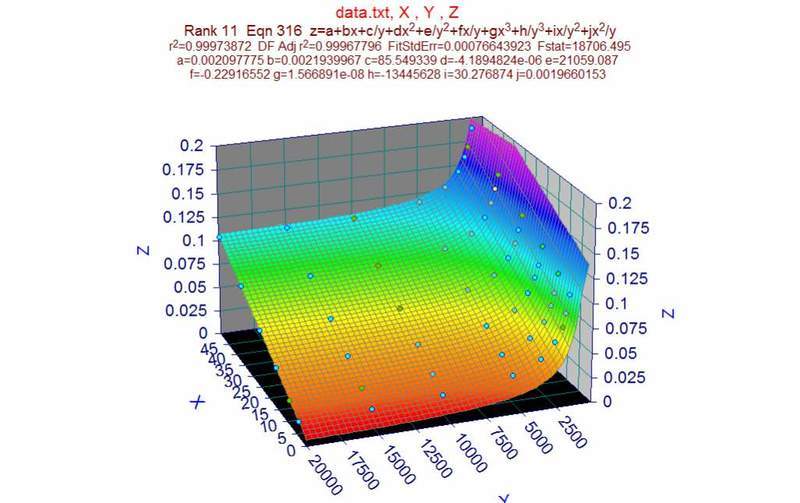

That's generally a very hard problem, unless you already know the basic equation of the surface.
In those situations where the basic equation is known, you can use your surface data to fit the equation to the surface using regression techniques. Still a lot of number crunching though, and what if the equation doesn't pass through the surface data in one or more regions?

The equation doesn't have to be perfect, as long as it's a close approximation.
I found another program that can do this. It has a database of hundreds of basic equations and it fits the best one automatically for you. I was wondering if Mathematica can do this.
In the case of this example it spat out the following:

Hi there, it is possible to generate an equation of a surface in Mathematica using the "Fit" function. This function allows you to fit a polynomial equation to a set of data points, such as the ones provided in your array. Here's an example of how you can use this function:
1. First, import your data into Mathematica using the "Import" function. In this case, you can use the "Table" format to import your data as a 3D array.
2. Next, use the "Fit" function to fit a polynomial equation to your data. You can specify the degree of the polynomial you want to fit, for example, a quadratic equation would have a degree of 2. The syntax for the "Fit" function is: Fit[data, {x^n, y^n}, {x, y}], where n is the degree of the polynomial.
3. Once you have your fitted equation, you can use it to find the value of the third variable given any two variables. For example, if you have x and y values, you can use the equation to calculate the z value.
I hope this helps and let me know if you have any further questions. Good luck with your work!
