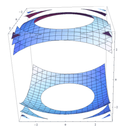

ok, I have tried and failed.
How does one graph the following on mathematica in 3D:
[itex]\left( x^{2} + \frac{9}{4} x^{2} + z^{2} -1\right)^{3} - x^{2}z^{3} - \frac{9}{80}y^{2}z^{3} =0[/itex] [itex]with -3 \leq x,y,z\leq3 [/itex]
If someone could give me the command (what to enter), that would help.
Heres what I tried:
Plot3D[f[x,y,z],{x,-3,3},{y,-3,3},PlotRange[itex]\rightarrow[/itex]{-3,3}],
where I pre defined f as the function above (this I'm fairly certain was done correctly)
ok, I tried the following and got the picture attached:
ContourPlot3D[itex]\left[\left( x^{2}+\frac{9}{4} y^{2}+z^{2} -1 \right)^{3} - x^{2} z^{3} - \frac{9}{80} y^{2} z^{3},\left\{x, -3, 3 \right\}, \left\{ y, -3, 3 \right\}, \left\{ z, -3, 3 \right\}\right][/itex]
It is, of course, not what I am trying to achieve...

I got it finally...
heres what I did
f[x_,y_,z_] [itex] = \left( x^{2}+\frac{9}{4} y^{2}+z^{2} -1 \right)^{3} - x^{2} z^{3} - \frac{9}{80} y^{2} z^{3} [/itex]
ContourPlot3D[f[x, y, z], {x, -3, 3}, {y, -3, 3}, {z, -3, 3}, Boxed -> False, Contours -> {0}, ContourStyle -> Red, Axes -> False,
Mesh -> None]
and I got the following graph (I haven't yet figured out how to resize it (by scaling within mathematica itself, not just re-sizing the image), since it is kind of small now
