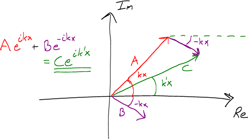

Now, what I then started thinking was: "Hmmm... This could be viewed mathematically as a sum of two vectors, and solution is simply another vector."
So I drew this picture to illustrate the idea:
So from that perspective it seems that the solution could also be written as
##\Psi(x) = Ce^{ik'x}##
However, using the simple constraints of the infinite square well quickly leads to problems - namely:
##|\Psi(0)|^2 = 0##
##C = 0##
So... Now really what I had hoped for. Where am I going taking a wrong turn? Has it to do with the x? That x should be x' also?

The problem is that your ##k'## is going to be a function of ##x##. As such, you can not assume it to be constant and apply derivatives to the wave function with that assumption.
Likes bhobba and Runei
Consider that ##e^{ix} + e^{-ix}## is equal to ##2 cos(x)## and so has no net imaginary component for all x. But a single ##e^{kix}## always has some net imaginary component (for finite ##k## and ##x##).
Thanks guys!
I gave it some more thought and think I nailed it down now.
