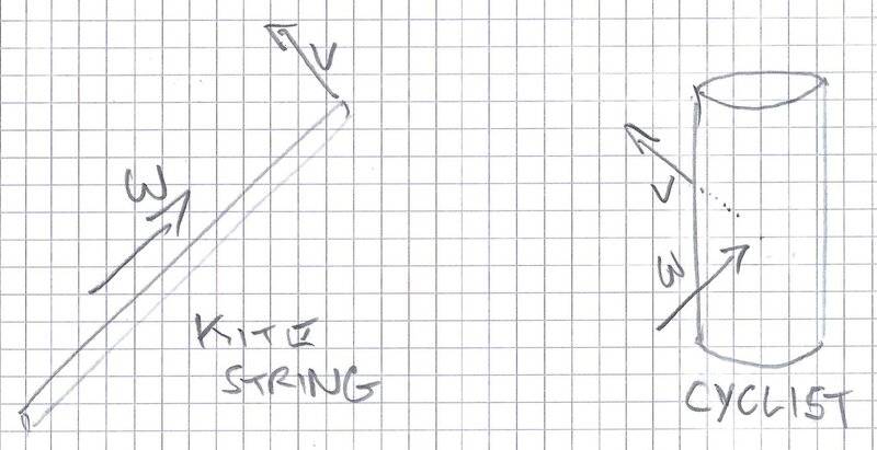

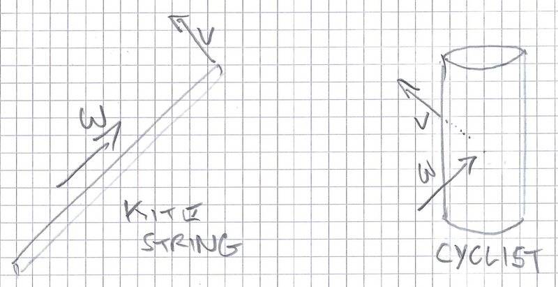

No, it was intended to illustrate the difference between the two models. I'll try a diagram instead:
haruspex said:
if an object is moving at velocity ##\vec v## in the ground frame and the air is moving at ##\vec w## in that frame then the relative velocity is ##\vec v-\vec w##.
That's all well and good, but if you want to calculate drag you need the surface area orthogonal to that relative velocity, and furthermore you will need to consider that (unless the kite is at right angles to the wind) some of that drag will increase the tension in the line rather than slow down the kite. If you do the math you will find that when the kite is approximately downwind then the contribution of the ground wind to horizontal tangential drag is small (and of course intuitively when the kite is exactly downwind it must be zero).
I think we can take the wind as being horizontal. Its velocity will have a substantial
component normal to the line.
The point of my intercession in the thread is to counter the argument in the problem statement that because the wind is orthogonal to the string's motion it is irrelevant to the drag. That does not depend on its being a kite rather than a bicycle.

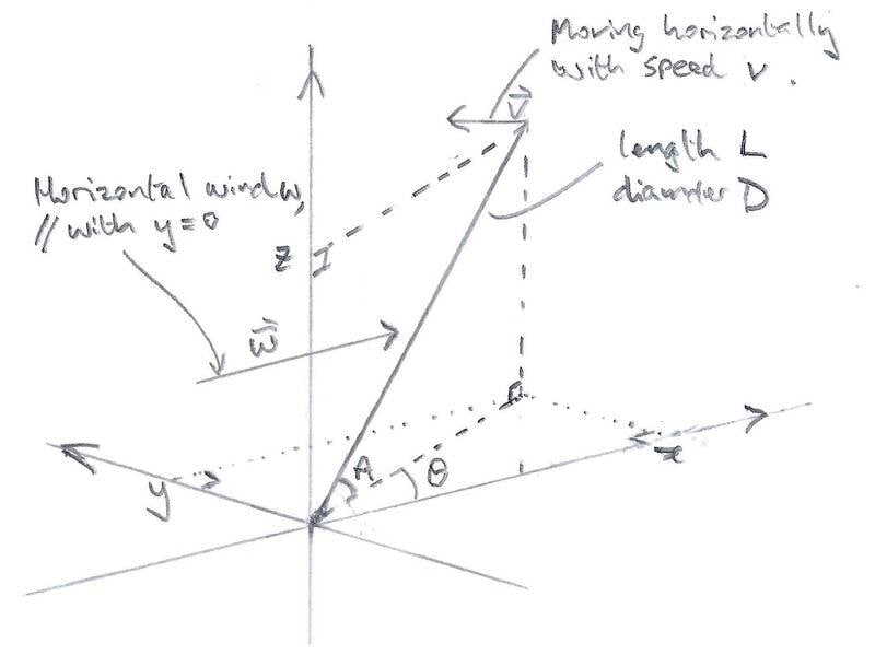

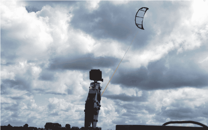

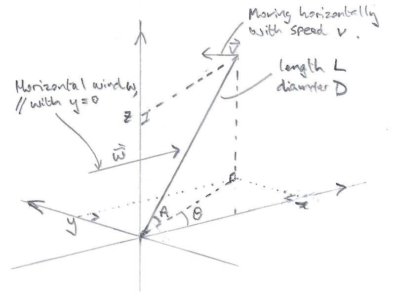

I will draw a diagram to get us all on the same page. I have based this on an image retrieved from https://www.researchgate.net/figure...be-kite-flying-crosswind-while_fig1_258351980
A-remote-controlled-25m-2-Leading-Edge-Inflatable-LEI-tube-kite-flying-crosswind-while.png
The tether is anchored at the origin. The tether is at a (constant) angle ## A ## above the horizontal and the [kite at the] end of the line is moving horizontally at ## | \vec v | = L \dot \theta = L \omega ##. The wind is horizontal and wolog assumed parallel to ## y = 0 ##.
Likes Tobi9242
Thanks for taking the trouble to do this, but as I keep explaining, my issue with the problem statement is that it implies, as a general principle, that crosswinds don't contribute to drag. That misleads students, and it seems the OP took it as true.
Whether the wind would contribute to the drag meaningfully in this specific case is somewhat secondary, so we should not really have taken up so much of the thread on it. So here I'll just say that to match your diagram (except A is already in use in the drag equation, so I'll call the tether slope ##\alpha##) I would change my equation in post #9 to
haruspex said:
The component [of drag] in the kite's direction of movement [at ##\theta=0##] is ##\frac 12\rho v\sqrt{v^2 +w^2\sin^2(\alpha)}C_d A ##.
If you are happy with that, we can move on. Otherwise we can take it a PM thread or some new public thread.
Not quite. I hope we can both be happy with ## \frac 12\rho v \ \sqrt{v^2 +w^2 \sin^2 (\alpha)} \ C_d(\alpha) A(\alpha) ## which recognises that the drag coefficient of a long thin oblique cylinder is different from that of one perpendicular to the wind direction, and that the surface area A must be corrected for the presentation to the apparent wind (I think ## A(\alpha) \approx A \cos (\alpha) ##).
We can then note that for sufficiently small ## \alpha ## (i.e. the kite near to downwind) ## w^2 \sin^2 (\alpha) ## reduces to zero and so the ground wind has no effect.
