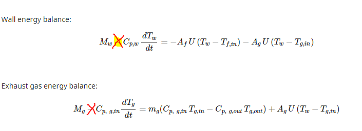

here are the equations please check and do the necessary corrections.
Working fluid energy balance:
M_f*(dh_f/dt) = m_f(h_fin-h_fout)+A_f*U*(T_w-T_fin);Wall energy balance:
M_w-C_pw*(dT_w/dt) = -A_f*U*(T_w-T_fin)-A_g*U*(T_w-T_gin)
Exhaust gas energy balance:
M_g-C_pgin*(dT_g/dt) = m_g(C_pgin*T_gin - C_pgout*T_gout)+A_g*U*(T_w-T_gin)
$$M_f\,{dh_f\over dt} = m_f\left ( h_{f,in}-h_{f,out}\right )+A_f \,U\,\left (T_w-T_{f,in}\right )$$Wall energy balance:
$$M_w-C_{p,w}\,{dT_w\over dt} = -A_f\,U\,(T_w-T_{f,in})-A_g\,U\,(T_w-T_{g,in})$$
$$M_g-C_{p,\;g,{in}}{dT_g\over dt} = m_g(C_{p,\;g,{in}}\,T_{g, in} - C_{p,\;g,out}\,T_{g,out})+A_g\,U\,(T_w-T_{g,in})$$
Where ...
(your post was hard to understand until I typeset the balances)
Several questions:
  1. What are you describing ? Drawing ?
  2. Units ?
  3. What tube ? What shell ?
  4. using M and m in a mixed mode is asking for errors
  5. Do you want an exhaustive, detailed dynamic model or something a bit simpler to begin with ? Perhaps even just a steady state model ?
  6. With 14 variables and 3 equations you still need to fix 11 variables before you can calculate anything. Which ones ? Either that, or you need more equations. See also point 5.
  7. You imply all U are the same ?
  8. Are you interested in the temperature of the wall ?
  9. etc
I really recommend you search for a simple textbook. Preferably your own from 'a while' ago (> 40 years ?)
so, basically i am using a shell and tube evaporator. units are all in SI units and temperature in kelvin. and M referes to the mass of the fluid and m referes to mass flow rate. I am looking for a detailed dynamic model of the evaporator if the unknowns are too many i can go with the basic model. U referes to over all heat transfer coefficient, which can be calculated using the basic equation. wall can be referred as a outer dia of the tube. I think i have all the other details like specific heat, inlet temperature of the cold and the hot fluid. what i need is the outlet temperature of cold fluid(water) and it has to be in vapour state. i have gone through few books like Refrigeration and air condition by P.K Nag, R.S Kurmi. If you know any better books can you please suggest me. In the equations it is not substract its a product on left hand side of the equation

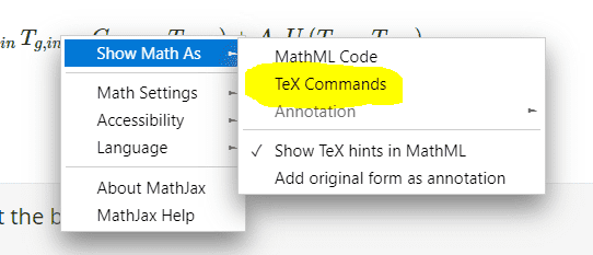

Sorry for misinterpreting your minus sign :wink: . If you use the right-mouse button while hovering above a ##\LaTeX## typeset equation, you can see the input to render equations in PF.
Very useful to learn some ##\TeX## for PF and elsewhere later on (I learned mine in the eighties... :smile:)
(enclose in $$ for displayed math, centered in new paragraph; or enclose in ## for in-line math formulas).

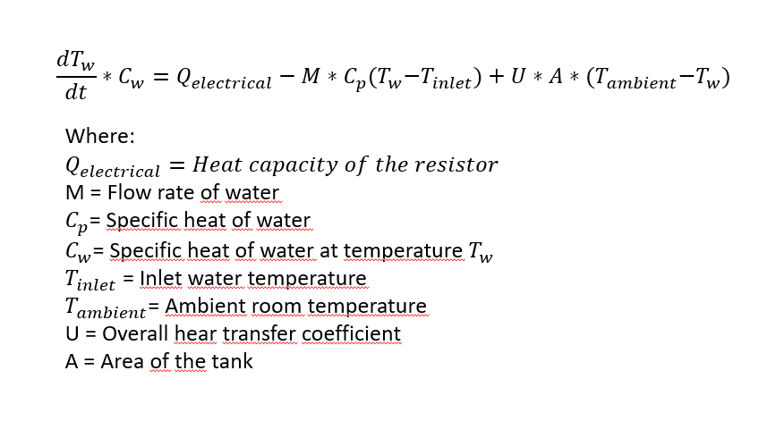

hello @BvU
I have modeled the equation for electric evaporator. I have attached the file here. But i have a small doubt in it how can i find that there is a phase change? I mean from liquid water to vapour. To my knowledge if there is a change in enthalpy that means there is a phase change. Is it correct?Can you check the attached file and can let me know wether i can use this equation for evaporation of water or not. If not please guide me through this.

Again, I wonder what you are modelling: if U = 0, as in the case of perfect insulation, you have less to worry about.
No. But the other way around: yes. If there is a change in phase, there is a change in enthalpy. A change, a jump, a discontinuity, whatever you want to call it. The enthalpy changes by ##h_{fg}## when the phase changes from liquid to gas at the boiling temperature.
A change in enthalpy also occurs with a change in temperature: ##c_p \equiv {dH\over dT} \Big |_P##
(liquid and vapour have different ##c_p##)
Table A.7 here is public, google 'PROPERTY TABLES AND CHARTS (SI UNITS)' for something better. Or use the steam tables once you understand what is going on in your setup.
The equation is suitable for an immersion heater with heat loss from the cup to the environment :rolleyes: .
Please use ##\LaTeX## instead of png o_O so the thing can be referenced and usefully processed otherwise.
I am sorry for the png. I will post a latex version from now on.
And yes, exactly I have modeled an immersion water heater. I got an idea in mean time that why can't i use an immersion water heater as evaporator? In precise both does the same work but when we use it as an evaporator there will be only a phase change from liquid to vapour. so if i did the enthalpy balance in this equation, I think i can use the same equation as an electric evaporator. Can you tell me your opinion on it.
Sorry i understood now. I need to model an electric boiler but not an electric heater if i want to convert water into steam.
Right !
