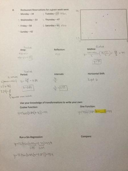

Restaurant Reservations for a given week were:
Monday - 34
Tuesday - 27 (minimum value)
Wednesday - 33
Thursday - 47
Friday - 58
Saturday - 61 (maximum value)
Sunday - 42
I don't think you need these equations to help me solve what I'm stuck on
Amplitude: Midline - minimum
Midline: Max + min / 2
Period: b = 2|max + min| then 2pi / b
What I don't understand is how to get the sine function of what I highlighted. I think you have to look at the parent function of sin and cos and try to get to sin. If I'm originally at (x-6) according to my Cosine function to the left of my Sine Function, where is that on the graph table of Cosine? And how do I get my new value if I want to go to the start of Sine?

Hi Buzz, are you asking about the parent functions and the domain and range? Because I don't think that matters for this. I just don't understand how to go from Cosine Function to Sine Function. I understand how to get Cosine function because that's what I did but Sine function is suppose to change. That's what I don't understand how to do but I think I need to look at the parent function. Ignore the Run a Sin-Regression because that's just the calculators calculation. Any ideas though?

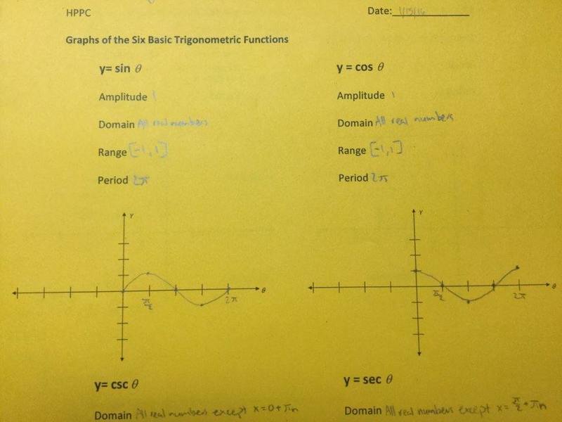

The reason I'm having trouble explaining this is because I don't know why the Sine function is suppose to change either. I can calculate the cosine function as I did but I need to move the horizontal shift so it matches the Sine function. The parent function is the 2 graphs shown in the second picture of Sine and Cosine, It's just suppose to guide you on how far the horizontal shift should change. I tried looking this up online but couldn't find any solutions. I don't know what I should do.

Hey Buzz, I have A, B, and D, I don't know how to calculate for C? Also, what is the variable t in f(t) = A sin ((2π/7) t) + B cos ((2π/7) t)? Is that suppose to be D?

hey Buzz, I have shown how to get A and B, and even D. A value: Mid - min (44-27 = 17), and B value: 2|max - min|, so 2|6-2| = 2|4| = 8. But use 7 instead because 7 days a week. (b = 2pi / 7 = 0.89). So now I need to use sin(x+y)?

Not sure I have understood, but I think all you are asking is how to take an equation like y=Asin(Bx+C) and turn it into y=Acos(B'x+C').
If so, consider what sin(π/2-θ) equates to.

It's fine, I was trying to see if there were any ideas which there were but couldn't conclude the problem. I do not understand the term regression. I didn't know how to show calculations for going from sine to cosine. No problem, thank you so much for your efforts.
(Note my use of B' in the cos form.)
I was actually trying to get cosine to sine
Yes, sorry, typo. But what I posted is still relevant.
