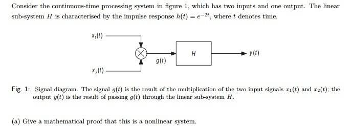

In summary: The input to the system is not just "x1" and "x2", it is also "g" which is not being accounted for in your equations. The system is nonlinear because the output of the system is not just a linear combination of the inputs, but also a product with the impulse response. Therefore, the system does not satisfy the condition for linear stability.

Consider the continuous-time processing system in figure 1, which has two inputs and one output. The linear sub-system H is characterised by the impulse response h(t) = e −2t , where t denotes time.
Block diagram is the product of x1(t) and x2(t) going through a block step of h(t) (exp-2t)
Give a mathematical proof that this is a nonlinear system.
Question attached in picture.
α1y1(t) + α2y2(t) = H {α1x1(t) + α2x2(t)} , condition for linear stability
where x1(t) and x2(t) are two input signals and y1(t) and y2(t) are the corresponding output signals for system H
Would my equations become
y1(t) = x1(t)e(-2t)
y2(t) = x2(t)e(-2t)
then calculating one way
y(t) = α1x1(t)e(-2t) + α2x2(t)e(-2t)
then the other
y(t) = e(-2t)[α1x1(t) + α2x2(t)] = α1x1(t)e(-2t) + α2x2(t)e(-2t)
But that would suggest linearity... Is there something I'm missing?

You seem to be missing totally that the input to H is g(t) and inventing two outputs y when there is only one.
Seem. Thisnis not my field but it sure seems.

Yes, you are missing the effects of "g".
