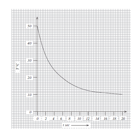

The graph shows the response of a bare thermocouple
which has been subjected to a step change in temperature from 50°C to
10°C. Assuming that the bare thermocouple behaves as a single transfer
lag system, determine the mathematical relationship between the
temperature (T) and time (t).
To=Ti*e-(t/τ) Eq1.
OR
f(T)=c*e-(kt) where k= LnT1-LnT2/t1-t2 =Ln5/-20=-0.08047 Eq2.
Using Eq2., where t=0 :
50e-0.08047(0)=50
t=20:
50e-0.08047(20)=10
So far so good looking at the graph but for other values of time such as t=6 :
50e-0.08047(6)= 30.85, which doesn't look right on the graph. Have I got the mathematical relationship wrong? Or is my time constant wrong?

This is not a 'relevant equation'. Insert t = infinity and what T do you get? You get T = 0 whereas obviously you are supposed to get around 10 deg C.
So how about T = Tie-t/τ + T instead?
Read Ti and T from the graph to compute τ.
Forget any 'curve fitting'. You were told to assume a 'single transfer lag' system. Use just the initial and final T points.

Sorry but how would I do that, I don't understand the method,sorry.
Think I have it :
T=T+a.e^(-t/τ) (where T = limiting value which is 10°C)
Choosing 2 points on the graph that are easily identifiable:
(x=time,y=Temp) : (16,11) and (8,16)
11=10+a*e^-(16/τ) (1)
16=10+a*e^(-8/τ) (2)
Simplifying by subtracting 10 from each equation and then dividing (1) by (2) :
0.1667=e^(-8/τ)
Solving for τ = 4.4654
Re-substituting τ into (1) and solving for a, a=35.985
So the full equation becomes T=10+35.985*e^-(t/4.4654)

I said to use the initial and final T points. You picked inbetween points that are hard to resolve and give a poor exponential fit for the empirical data you're looking at so you got way the wrong value for "a".
One look at the graph should tell you "a" (= Ti) very precisely! Then, compute τ.
Im having trouble with the math:
T=T∞+a.e^(-t/τ)
T∞=10
a=50
T=50 at 0s
50=10+50e^(0/τ) is unsolvable
T=10 at 20s
10=10+50e^-(20/τ) is unsolvable

How about t = 4?
10+50e^(-4/τ)=50 , τ=-4/(ln(4/5))=17.92
why t=4??
Im a bit lost now. I don't think this equation is working.
a is not 50
why t=4??
Because that gives you a good measure of τ. You're not going to get τ at Ti or Tf; the curve could drop from 50 towards 10 very slowly or very quickly or anything inbetween. And τ tells you how fast or how slowly the curve drops, right?
It is if you use it right!
The equation is T = Tf + a e-t/τ. When t=4 what is T?

Sorry I need some clarity here because it is getting too confusing, I need more methodology here and the correct syntax. According to my notes;
T = Tf + a e^(-t/τ)
T= output value
τ= system time constant in seconds (a*0.368)?? i.e one time constant equals 36.8% temperature input
a= magnitude of the step change (50-10=40)??
t=elapsed time
Tf or 'C' in my notes= final value of a when t >> 5τ (10)??
The equation is T = Tf + a e-t/τ. When t=4 what is T? On the graph its looks to be about 24°C although I am sure this is not what your asking.
Do I have the right values for all the variables in the equations?
Initial and final T points are 50 and 10 respectively?
T = Tf + a e^(-t/τ)
T= output value
That statement makes no sense to me. Just consider τ a constant with the dimension of time for now.
right but it's not a step change. It's the difference between T(0) and T(∞).
t=elapsed time
right
That's exactly what I'm asking and that's correct. It's T(t=4) = 24 .
Absolutely!
You're getting there.
Okey doke here we go T = Tf + a e-t/τ. I can see what you mean when you say you have to use a figure inbetween the initial and final points
T(4) = 10 + 40 e^-4/τ
24=10+40e^-4/τ
solving for τ :
τ= -4/ln(7/20) = 3.81
T(t)=10+40e^-t/3.81
T(20)= 10+40e^-20/3.81=10.21 (close to final value although it never touches in reality)
T(0)=50 as e^0 =1

Yes!
You can also check you equation fo T(∞) of course.

I was following this thread and I was just wondering why you used t = 4? In my notes it tells me that
"The important thing to realize is that the time constant is the time taken for 63.2% of the full change to occur"
In the case of this question we started at 50 degrees and ended at 10 degrees, a change of 40 degrees.
63.2 % of 40 is 25.28. 50 - 25.28 = 24.72
I know its not exactly 24 but I was just wondering if there was a connection at all ??

I struggled with this in the beginning but if you follow all of the posts in this thread the correct method is explained.
I used ##T=T\infty+a*e^(\frac{-t}{\tau})##
##T\infty## is the final limit which in the case of this question is 10
##a## is the difference between ##To## which is 50 and ##T\infty## which is 10 so a must = ...
the task in hand is to identify the time constant ##\tau##
I picked 10 points from the graph given in the question, the first point being ##x=2, y=32.5## and the last point being ##x=20, y=10.1##
so I found ##T=32.5## and ##t=2##
I then plugged these values into the equation and after evaluating for ##\tau## i had a time constant for my first point which equated to 3.51
I did this for every point and took all of the values and found the mean value. I used this mean value for ##\tau##. When i used it in the equation ##T=T\infty+a*e^(\frac{-t}{\tau})## it proved to be very close to ##T##
I think as suggested by the lady in post 2, the more points you use the closer you will get. My answer was marked correct
I also created a graph in excel to try and get as close as possible.
