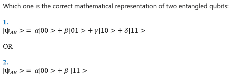

May I know which one is the correct mathematical representation of two entangled qubits:
*Please refer to the attached file.

I'm a first-time user... Now I'm investigating how to write the equation directly in this post. How about this?
Emrissa said:
How about this?
That's an image, which is still not acceptable. As I said, you need to use the PF LaTeX feature to post equations, and there is a "LaTeX Guide" link at the bottom left of each post window that will help you with that. Text that isn't equations can just be written directly in the post, as you have been doing.

@Emrissa, as an example of how to use the PF LaTeX feature, I'll post your two equations, first showing the LaTeX code and the other text just as you would type it in the post window, and then the result when that code is posted.
Code:
Which one is the correct mathematical representation of two entangled qubits?
1.
\ket{\Psi_{AB}} = \alpha \ket{00} + \beta \ket{01} + \gamma \ket{10} + \delta \ket{11}
or
2.
\ket{\Psi_{AB}} = \alpha \ket{00} + \beta \ket{11}
1.
2.
Likes Emrissa

Dear Sir,
Thank you for your guidance 🙏
The answer to this is that state #1 is not entangled and state #2 is. However, state #2 is not the only possible entangled state of two qubits. So there is no such thing as "the" correct mathematical representation of two entangled qubits.
To see that state #1 is not entangled, consider:
\ket{\Psi_{AB}} = \left( a \ket{0} + b \ket{1} \right) \left( c \ket{0} + d \ket{1} \right)
Multiplying out the factors gives:
\ket{\Psi_{AB}} = ac \ket{00} + ad \ket{01} + bc \ket{10} + bd \ket{11}
Since ##a##, ##b##, ##c##, and ##d## were all arbitrary coefficients, we simply set ##\alpha = ac##, ##\beta = ad##, ##\gamma = bc##, and ##\delta = bd##, and we have a factorization of the original state #1. Since the state can be factored into a product of one-qubit states, it is not entangled.
Likes Emrissa
