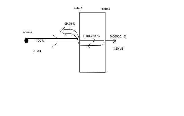

Hi Everyone, this is not a school work problem, I would have stated that if it was - this is a work problem; I want to know how loud my control panel is going to be. I exaggerated the thickness of the steel, so I could see and understand the maths and do the calculation myself with my actual values.
The control panel has a number of devices in it that accumulate to 70dB, this is inside a mild steel enclosure of 1800mm High x 1600mm Wide x 500mm Deep - assumed that the components producing this noise would be in the center of the enclosure.

So you are not dealing with the transport of sound through a bulk material. It is as I suspected, the sound being transmitted by flexing of the sides. The Zsteel is not so relevant and it is the surface density and the flexing modulus that count.
If you just need to reduce the level of sound escaping then you could brace and load the plates and possibly use the sound damping materials that are used on car body panels. There are images of what I mean in this link and this link. The whole enclosure should be sealed for a start because sound can escape from small holes, joints and slots. How many dB of reduction do you need? It's best to be aware of what you could expect from the various measures you could take, especially if it involves dismantling and rebuilding the enclosure. The enclosure needs to be totally sealed from the room, possibly venting to the outside if necessary. Also, the panel needs to be as massive as you can conveniently provide.

I have attached a crude drawing of the system indicating the reflected and transmitted acoustic power using the equations for the reflection coefficient ##R=(\frac{Z_{steel}-Z_{air}}{Z_{steel}+Z_{air}})^2## and the transmission coefficient ##T=1-R##. I didn't account for attenuation due to distance from the plate.
This is of some interest but only in a situation where there is no net movement of the plate so it is just not a relevant model for use. (Maths does not dictate results - it's the Physics that dictates which Maths to use.) Your model assumes that the plate is firmly held in a small but strong tube and that it doesn't move or distort.
I suggested that you should compare any numerical results you get with 'your' approach and compare them with the results quoted in the second Engineers' Toolbox. Your 120dB doesn't look like the 40 dB or so that a well made screened enclosure can give you - and I gave you the reason - you have done the wrong sums so there is no surprise.
