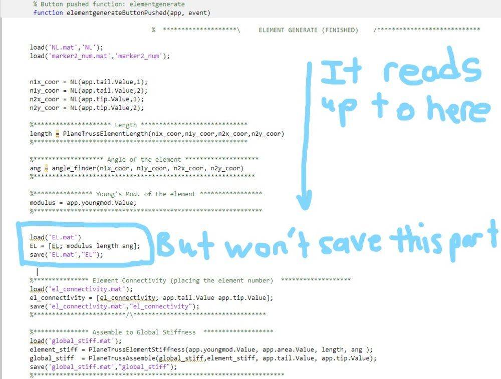

It's an Finite Element Method homework to write a code for stresses of the bar and to create a GUI for that.
EL = represents Element Matrix but it contains properties of the specific element.
At the start up section I initialize a matrix like:
EL = [ ];
save('EL.mat',"EL");
-------------------------------------------------- This part is okay it creates and saves an empty matrix.
But later, when a button pushed it should record the values of the edit box like:
(This is the section under the app.buttonpushed)
load('EL.mat');
EL = [EL; young_mod length ang];
save('EL.mat', "EL");
---------------------------------------- everything in this buttonpushed section works except this one because when I write load('EL.mat') into command window it returns an empty matrix. I even wrote fprintf('abc'); above load('EL.mat') but it didn't print it.
It made me crazy, it does not read the specific portion of the code and just skips it. I also share the code for you. Please enlighten me.
I found the problem it's a foolish mistake :) I had a reset section between the saving and loading part and it was resetting all the variables. Problem solved.
