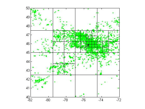

I have a dataset of events that have geographical coordinates and a magnitude. The location plot looks like this:

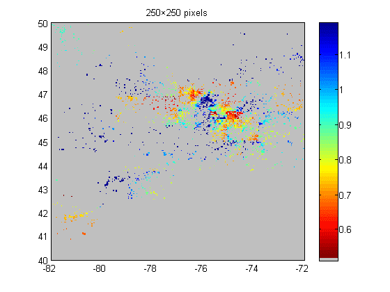

Some areas are very densely populated, some are sparsely. To get the feel of the magnitude of these events, I've made a grid and put each event into its own pixel. The pcolor function gives me this color-coded plot:

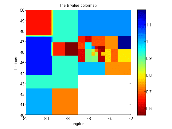

Again, the spatial sparcity of the events works against me as most of the picture is just grey (0 value). So the idea was to assign areas and come up with an average magnitude for that area that all events in that area contribute into. The first idea was to use squares; using pcolor for color-coding this is what came up:

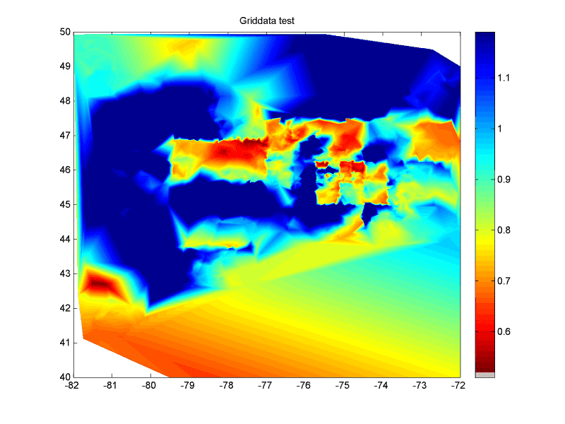

This plot lacked fluency so I used interpolation to make the transition between areas smoother. This is what I got, again using pcolor function:

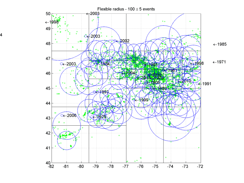

Now I realized that the boxiness of the areas felt false so I abandoned square areas and went to circles. This are the circles I designated:
Each circle has its magnitude assigned, now I want to put those values down into a matrix so I can use pcolor again in hope that it will look like the over-boxy color-coded picture above.

1) Are the circles (a) a sampled region in which you count the number of events (and that's your magnitude) or (b) is the magnitude encoded in the size of the circles?
2) If a), how do you interpret overlap then? Aren't you counting events more than once where there's overlap?
Yes, circles overlap and some events are taken multiple times. I intend to draw the big circles first and then smaller on top of them so the values of pixels would be overwritten.
