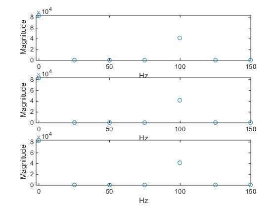

this is the spectrum of the 3 signals:
So there is a huge spike at zero Hz.
I have composed each signal multiplying 2 previous signals that where at 50Hz. So I expect the new signals to be at 100 Hz. And I see a spike there.
But I don't understand why the spike in zero.
You have a DC component in you signal. max function should detected the peak of the periodic signal ?

when I use max function it gives back the index of frequency = 0 HZ
Then the answer is correct, the DC components have zero phase shift :)
well, ok that's correct.

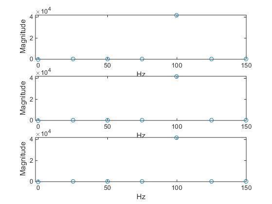

Since I need the 100Hz I subtracted the mean value of the signal to itself.
thanks a lot!
The zero value of the Fourier transform will always just be the mean give a or take a factor of pi and volume.
In general, it's usually a good idea to make sure the signal you wish to pass through your FFT has zero mean, that way you are only dealing with nonzero frequency components.
the original 2 signals had no DC component. But by multiplying them value by value the resulting signal was no longer centered on the zero for the vertical axis.
Pretty obvious after you get it..
