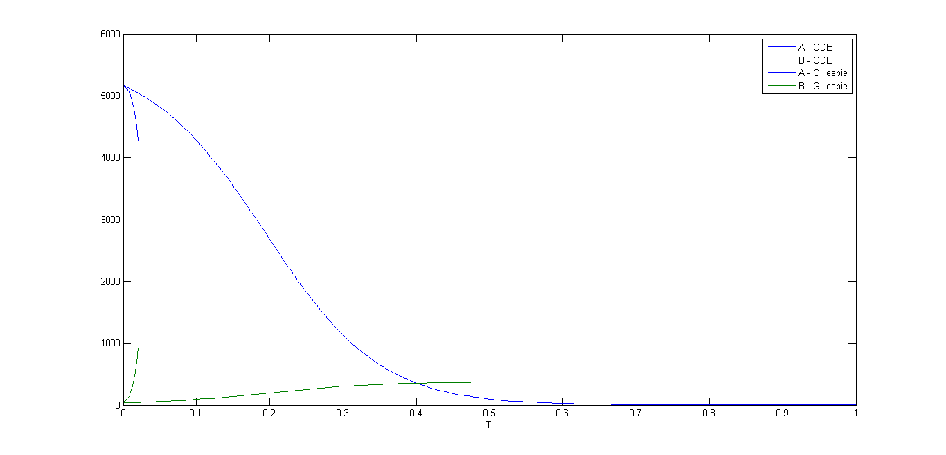

Copy and paste if you want to use any of this code. Its a simple iteration of converting biomass of elk into new wolves.
Code:
% example for ODE and Gillespie
% one reversible reaction
 b1 = .033;
bo = .00047;
a1 = .0022;
ao = .00055;
Aini = 5168;
Bini = 34;
%% Basic ODE simulation
dt = 0.01;
Tmax = 1;
TV = (0:dt:Tmax)';
NT = length(TV);
ABVals = zeros(size(TV,1),2);
A=Aini;
B=Bini;
ABVals(1,:) = [A, B];
% loop over times
for it=2:NT
    dAdt = - b1*A*B + bo*A;
    dBdt = a1*B*A -ao*B
    A = A + dAdt * dt;
    B = B + dBdt* dt;
    ABVals(it,:) = [A, B];
end
figure(1)
clf;
plot(TV,ABVals);
xlabel 'T';
legend('A','B');
hold on
return;
%% Gillespie
% loop goes over time steps
%Tmax = 1;
MaxSteps = 1000;
% define a large array to record everything
ABRecord = zeros(MaxSteps,2);
TRecord = zeros(MaxSteps,1);ABCount = [Aini,Bini];
t=0;TRecord(1) = t;
ABRecord(1,:) = ABCount;
istep=2;
while (t<= Tmax  && istep<=MaxSteps),
    A=ABCount(1);
    B=ABCount(2);
    % propensities ('gamma')
    PropElkEaten = b1 * A*B;
    PropWolvesBorn = a1*A*B;
    PropWolvesDie = ao*B;
    PropElkBorn = bo*A;
    % distribution of next reaction times follows exp( - gamma * t)
    NextFwdTime = exprnd(1/PropElkEaten,1);
    NextRevTime = exprnd(1/PropWolvesBorn,1);
    NextWolvesDie = exprnd(1/PropWolvesDie,1);
    NextElkBorn = exprnd(1/PropElkBorn,1);
    if NextFwdTime < NextRevTime,
        % forward reaction (A->B) happens
        t = t + NextFwdTime;
        ABCount = ABCount + [-1,1];
    else
        % reverse reaction (A->B) happens
        t = t + NextRevTime;
        ABCount = ABCount + [1,-1];
    end
    % record
    ABRecord(istep,:) = ABCount;
    TRecord(istep) = t;
    % done with this step, increment the step count
    istep=istep+1;
end
if istep-1<MaxSteps,
    TRecord = TRecord(1:istep-1);
    ABRecord = ABRecord(1:istep-1,:);
end
figure(1)
stairs(TRecord,ABRecord)
legend('A - ODE','B - ODE','A - Gillespie','B - Gillespie');
