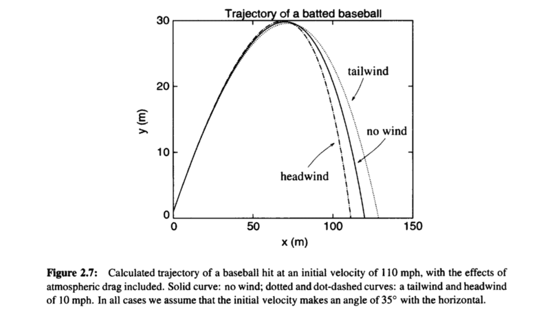

I am trying to create this plot in MatLab
I'm starting out doing the simplest one, no drag, no wind. simple kinematics, right? but I can not get my code to run.

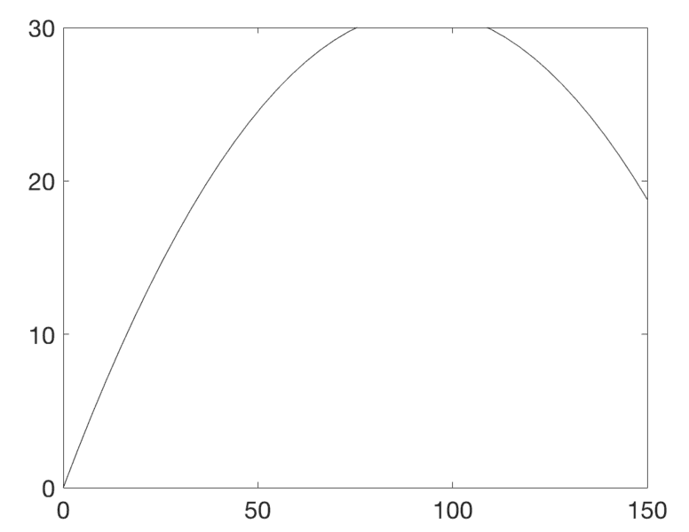

whenever I try to plot, I get a linear line. and the graph doesn't even have the correct domain and range or increments. It is weird because I borrowed the code from a previous problem I did, and just changed a bit of it.
I'm certain the problem is probably with my matrices, but I am still new to this. At this point I am just tackling the baseball in a vacuum part of the plot.

Your X and Y equations are essentially identical, so the plot will be linear. Gravity does not effect the X velocity (if that is horizontal).
FactChecker said:
Your X and Y equations are essentially identical, so the plot will be linear. Gravity does not effect the Y velocity (if that is horizontal).
But they aren't identical. the acceleration in the X equation is 0 so that term is 0. the y equation has an acceleration of -9.8 so it should go up and then come back down.
What did I do wrongedit: I see what I did. I see what you are referring to. right variable in one part. wrong variable in another. for x

Regardless of how they start and the initial rates, the horizontal position and velocity (I guess the X values) should not be affected by gravity.
PS. I changed the horizontal from Y to X in my post #2.

OK! Now we are making progress. I corrected my formulas, and the graph is parabolic the way it should be. but it is not showing the correct domain and range. it's like from something to 0 in both the domain and range. I don't get it.

The thing to do is to nurse it through step-by-step and see that each step calculates the values that make sense. Running the whole thing fills up the screen and all I can see is that all your X and Y values are negative and get more negative with time. That is wrong. Try one command at a time from the beginning.
sin() and cos() usually need inputs in radians, not degrees.
that's it. I did not know that. but converting degrees to radians brings me very close to my desired plot.
it's not perfect though. it looks weird. it is plotting more points than I told it to, and seems to be calculating more than what I think I told it to.
grandpa2390 said:
timeToMaxHeight = -initialVelocity / gravity
You might want to rethink this.
Likes grandpa2390 and FactChecker
darn Typos. Even using descriptive variable names, I still miss them. That seems to do the trick. the domain and range are still a bit weird though. It isn't going to match the picture yet because the picture has drag and wind effects applied. but why is the y-axis starting so high?

That's the same plot that I expected. The Y axis goes up to 40 because it is marking in increments of 10 and the Y values go slightly over 30. Usually I initially let MATLAB decide it's own axis limits so I can easily get the whole picture and then I specify different limits like ylim([0 32]) if desired.
So how do you do that? where do type ylim([0 32]) at in the code? I thought linspace was supposed to handle that. but it isn't do a good job of it for me.
After the plot and before the "hold off". I don't know why the linspace doesn't work, but you have two of them. The documentation I see for linspace does not apply to a plot.
Likes grandpa2390
Beautiful!
Don't worry, I'm not crazy. The actual plot I am working toward will include drag. And the ball will hit its peak at about X=70 and land somewhere at about X=120. But first things first. Have to figure out how to do the simple things (like simple kinematics) before I start tossing in more complicated things like drag :) :) :)
