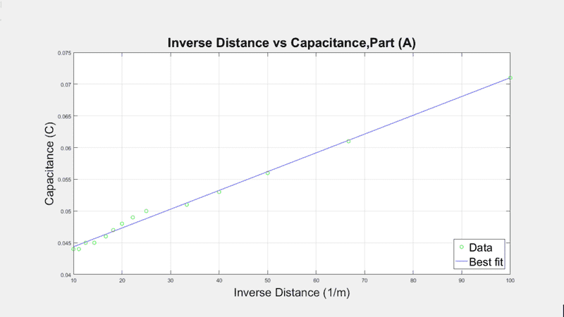

I have a lineer data and I want to write the equation of it on the graph.
The x-axis is inverse distance (1/m) and I showed as "d"
The y-axis is capacitance (C) and I showed it like "C"
My data name is d_C
Here my codes that I used for now

I just need to write the equation on the graph like probably y=0.0003x+0.0414 (I am not sure about this though).I need codes.I can't do it on manually
Any help would be great
Thanks

From a MATLAB newsgroup post:
[p]=polyfit(...);
a = p(1)
b = p(2)
polyfit_str = ['y = ' num2str(a) ' *x + ' num2str(b)]
% polyfit_str will be : y = 4*x + 2
text(10,10,polyfit_str);
Likes Arman777
Thanks a lot.I did it
