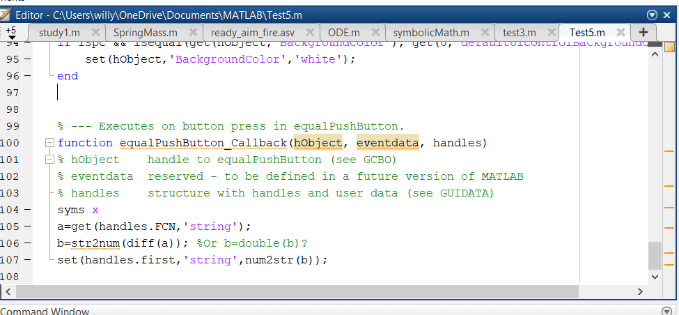

Happy Sunday, I am trying to create a MATLAB GUI that can take an input ( i am starting out with just one variable) and take its derivative and display the result. I have attached pictures of what my GUI looks like, and also the code I wrote so far.

I am running into some problems and I think I know why, but cannot seem to figure out how to fix it. Here is what I did
I went to the callback of the pushbutton and added:
syms x (I did this because I was thinking I had to define the variable..?)
a=get(handles.FCN,'string') This is getting the value from the edit text box
b=str2num(diff(a));
set(handles.first,'string',num2str(b));
As an example I would like my program to be able to handle "4x" as an input and when you hit the push button spit out "4" in the static text box (without the quotes).
I believe the problem is somehow I am not telling MATLAB that we have numbers and letters being typed into the edit text box...
I am new to MATLAB and it is pretty difficult to me so any help would be appreciated. The simpler the explanation the better for me.

Orodruin said:
https://www.mathworks.com/help/symbolic/str2sym.html
Other than that, you cannot just enter 4x. Matlab will want the multiplication operator.

Yeah, unfortunately the documentation that Mathworks has on their site is challenging for me to understand, that's why I'm here asking questions! I assume posting this was supposed to steer me in the right direction of using str2sym somewhere? Would I be using str2sym when I am assigning my "b" variable to be the derivative of my "a" variable (the one the user inputs)?
Thanks
Your variable "a" is a string and not a symbolic expression that can be evaluated. In order to turn it into a symbolic expression, you will need to convert it to one using sym2str, which is what that function is for. If you do not do this, you will not be able to take the derivative of it.
