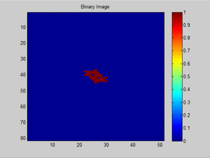

I have found the 2D Fourier transform of a figure and then changed it to a binary image (attached).
I want to find the line of best fit through the longest "axis"? of this figure. What would be the simplest way to accomplish this?

You can use polyfit() for best fit lines:
Code:
p = polyfit(xdata, ydata, N)
xdata: the x-axis values
ydata: the function values corresponding to the values in xdata
N: degree of the fitFor a linear fit, use N = 1.
Wouldn't polyfit require vectors for each data set? right now I have multiple y values for each x value.
Yes you're absolutely right. I just looked quickly; polyfit doesn't work when there are repeated (or nearly repeated) xdata points.
Is it feasible to average all of the repeated xdata points so that you just have 2 vectors with 1 function value for each x value? Then you can use polyfit with that data set. It seems to me like it might produce something reasonable, but I'm not a statistics expert.
If so, you can use accumarray to perform the averaging.
That should work since the figure is symmetrical, I'll give it a shot. Thanks
If you are talking about a linear line, you can calculate the linear regression of Y as a function of X. Because it works when random errors are added to Y, there can be multiple Y values for the same X value. Alternatively, the principle component that can be calculated through the data set.
