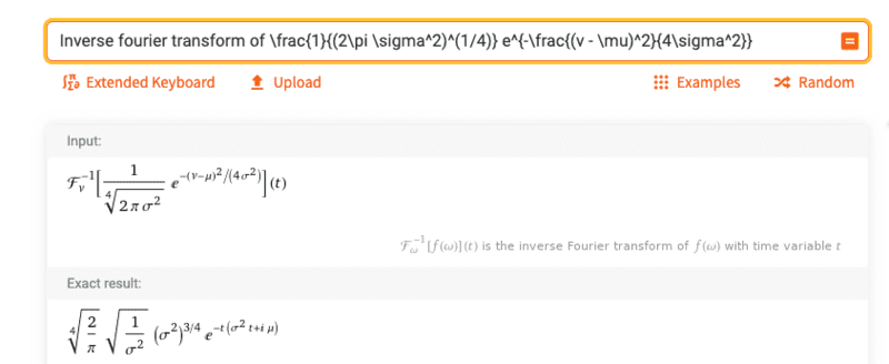

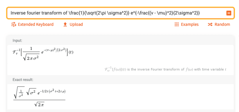

Now, I will write a more detailed explanation of what I was trying to do. I have considered a Gaussian-shaped spectrum for Doppler velocities that follows the following equation,
S(v) = \frac{1}{\sqrt(2\pi \sigma^2)} e^{-\frac{(v - \mu)^2}{2\sigma^2}}
Here,
It is assumed to be a group of scatters of different shapes and sizes moving with different velocities.
I want to see how does it look in the time domain when the radar is receiving this signal in slow time. As this is a power spectrum, for the time-domain we need the IDFT of the square root of this power spectrum (voltage equivalent).The pulse repetition time is 1 [ms], which corresponds to a pulse repetition frequency of 1 [kHz].
The velocity axis is,
v = [-\frac{\lambda}{4 \delta t}, \frac{\lambda}{4 \delta t}) with steps of \frac{\lambda}{2 N \delta t}.
The N is the number of pulses, the \delta t is the pulse repetition time, \lambda is the operating wavelength.
I approached it in two different ways. First, in MATLAB numerically using ifft function. Second, using MATLAB but analytical expression obtained from WolframAlpha (The mathematica engine). The screenshot is attached from Wolfram Alpha. As, in WolframAlpha it just converted from frequency to time, I used some modifications which may make it a velocity-time conversion.
The expression I used is this,
s(t) = (\frac{2}{\pi})^{1/4} \sqrt{\frac{2\sigma}{\lambda}} e^{-t ( (\sigma \frac{4\pi}{\lambda})^2 t + j \mu \frac{4\pi}{\lambda} )}The code is shown below.[CODE lang="matlab" title="IDFT"]clear;

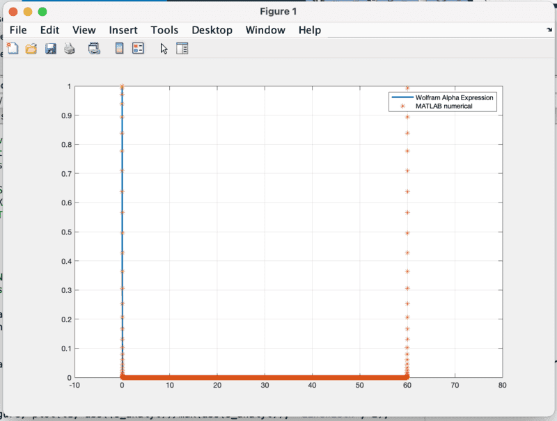

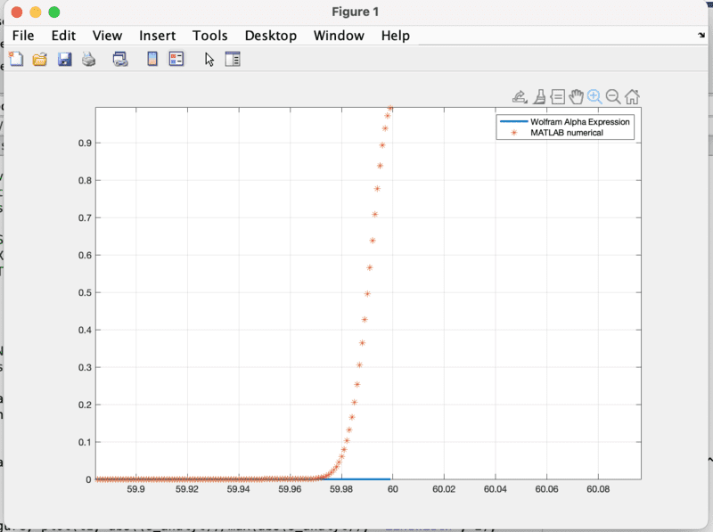

legend({'Wolfram Alpha Expression', 'MATLAB numerical'})[/CODE]The results are shown. Here, I don't use any ifftshift. I have put one zoomed in image near time 0 and one at time 60 [sec]. These are the extreme time values. In the MATLAB one we see at both edges we have a pulse. However, we don't have it in the analytical one. It has the pulse only at 0.
