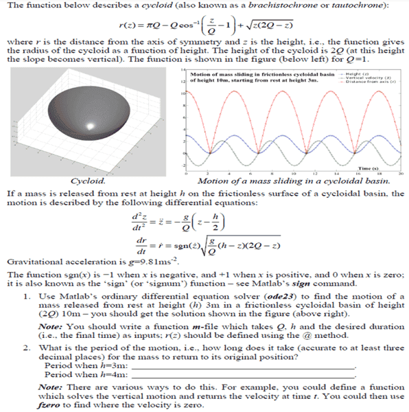

Hi, I currently have this problem to solve, and I'm quite stuck. I would much appreciate it if anyone could point me in the direction on how to solve it.
This is my go at it, although currently I don't have access to MATLAB until tomorrow as the university library has now closed.
Is this the correct way to get the motion? If I then turn it into a function?
Many thanks.
Regards,
intrepid44
The last bit should be: >> f = @(t,z) [z(2);-1.962*z(1)-2.943];
Got it sorted, never mind.
