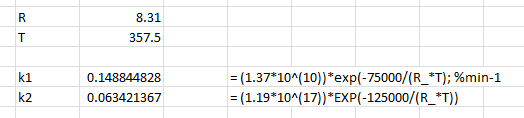

- exp(-75000/R*T) (and the other exp as well) is always zero, after googling a bit seems like it should be exp(-75000/R/T). This explains the insensitivity on x0.
- Even after this, the value of the two k's are extremely small (9e-30 or so), which seems incorrect, or if not, then it will lead to all sorts of numerical trouble. Is this 75000 (activation energy?) correct?
- in the formula for k, the value of (1.37*10^(10)) seems very large, is this the molar concentration? Which you also specify in y0? there it is in the order of a few 100, not 10 billion.
So, that's where I would start, good luck!
Likes Will26040 and BvU
Not a chemist either, but
  • I second @Arjan82: ##\ \ e^{-E_a/(RT)}##
  • T = 100 K is way too low a temperature to get the reaction going :wink:
  • You have ra = -k1*Ca; so you don't want dCadL = -ra/u; but dCadL = +ra/u;
  • What about L ?

I don't have MatLab, so I fumble with Octave (And with excel ?:) ) found about 357.5 K.
Did you have to make any other changes ?
Likes Will26040
thanks that's what I got too. I didnt have to make any other changes

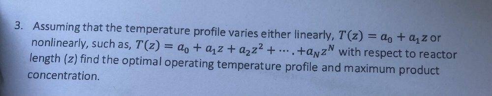

I now have a second part which I was wondering if anyone could help me please. You have to assume that the temperature profile varies nonlinearly with length (z) of the reactor:
##T(z)=a+bz+cz^2##

Im not sure if I am going about it in the right way. Should the equation for how T varies with length be a nonlinear equality constraint? thanks

Hi, thanks for your patience. I have attached the actual question; it still is T that I want to optimize, however you have to assume it varies non-linearly with the length- which is fixed at 2m. I have assumed the relationship
##T(z)=a+bz+cz^2##
I am not sure if I am doing it right.
Will26040 said:
I was just wondering in the post that you helped me with you said 'T = 100 K is way too low a temperature to get the reaction going' I was just wondering how you knew this? I think I'm meant to derive some constraints or something. thanks
I simply calculated a few k values
Inspired by previous painful :smile: experience mixing up temperatures in C and K.
In numerical solvers and such it is indeed often a good idea to restrict the range of ##T## and to work with a $$k_0' = k_0\, e^{-{Ea\over RT_0}}$$ that isn't so huge so that $$k(T) = k_0' \, e^{-{Ea\over R}({1\over T}-{1\over T_0})} $$to avoid problems with the argument of exponentiation.

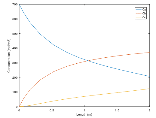

So I tried your code from #9. With a few mods it runs in Octave
Matlab:
function main %(pkg load optim can be done in command window)
A=[-1 0 0 ]; B=[0];
Aeq=[]; Beq=[];
LB=[]; UB=[];
Nonlcon=[];
T = 350;
a = -1;
b = -1;
x0 = [T a b];
options = optimset();
%x = fminunc(@fun,x0,A,B,Aeq,Beq,LB,UB,Nonlcon,options)
x = fminunc(@fun,x0,options)
end
In short: ihave no idea what A,B,Aeq,Beq,LB,UB,Nonlcon, are supposed to do.
But weven without those, it runs and terminates with a picture
and
Code:
f =
  -97.503
   33.805
   63.698
obj = -370.26
x =
   369.0975   -21.3115     6.9389
which may or may not be a reasonable outcome.
I would expect you need to bring in other cosiderations to deal with question 3. After all, yield is one single number and optimizing ##a_i \ \ i \in (0...N)\ ## is N dimensional. Don't know how to tackle that.
When I look at the profile: I kind of expect ##C_b## at 2m to be at a maximum is equivalent to ##r_b =0\ ## at that point, but the figure doesn't show that.
I may find the time to plod through a book on reaction engineering at some point, but at the moment I can't help much further I'm afraid.
