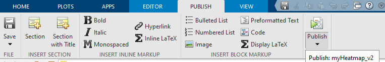

Not sure if this helps exactly, but if it's specifically a MATLAB report, there is a *publish* option that will export all codes triggered and output in command window along with a table of contents.
