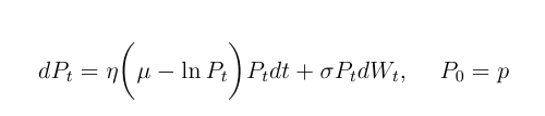

Hi all,
I have this dynamic:
is a Mean Reverting process. I want to simulate the sde with MATLAB but I am a beginner and I have some problems. I show you the code that I have created:

But I don't know if it is correct. Can you help me?

It is not OK. The discretization of the Wiener increment is wrong. Here is the first link that I could find that explains how to do it correctly in Matlab:
http://www.caam.rice.edu/~cox/stoch/dhigham.pdf
To summarize: [itex]dW \approx \sqrt(dt)N(0,1)[/itex], so you forgot to multiply your dW by the square root of dt.
Also, the wikipedia entry for the first order scheme has some example code for exactly this problem:
http://en.wikipedia.org/wiki/Euler–Maruyama_method
Note that this is a first order discretization, there are also higher order methods that you can find in the literature, e.g. in the book of Kloeden and Platen. I highly recommend this book if you want to numerically solve stochastic differential equations. The basic idea of these methods comes from Ito calculus and the idea of stochastic Taylor expansion.
