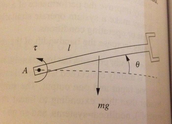

I need to use Simulink to determine an approximate numerical solution to the equation of motion for a robotic arm (image below). The equation of motion for the system is J (\theta)'' = \tau - mgl cos (\theta). (An ordinary, 2nd order nonlinear differential equation.)
Assuming zero initial conditions and a small desired angle of the robot arm, I need to verify the following rules of thumb for PID control for a step input.
- for proportional control (Kp > 0, Kd = 0, Ki = 0), the solutions are oscillatory, and Kp increases the frequency of oscillation (which decrease the rise time and peak time), but decreases the mean steady state error. The settling time is finite (Hint: pick a starting value of Kp = 5)

I am really struggling with how to use Simulink, and especially how to do this in Simulink. Any tips/advice for a starting place to solve this problem would be GREATLY appreciated! I would really, sincerely appreciate any and all help with this! Thank you!
It's hard for me to give an "attempt at a solution" when I am completely lost :( I am not asking for the answer, I just want to know where to begin. Please please, understand. I understand the relationships between items (a) through (d), but I do not know how to even begin to use Simulink, or model this equation in Simulink. Thank you again in advance.

For PID tuning the "rules of thumb" vary with the stiffness of the system being controlled!
For hydraulics you can start with all Proportional, but applied at a slow rate.
Then if you don't want to go past your objective (e.g., bang into stuff), you add Integral until the limits are honored.
Finally, you add Derivative (very small amounts) to get rid of the "ringing".
So it is an iterative process - it goes much faster if each iteration is a computer simulation!
